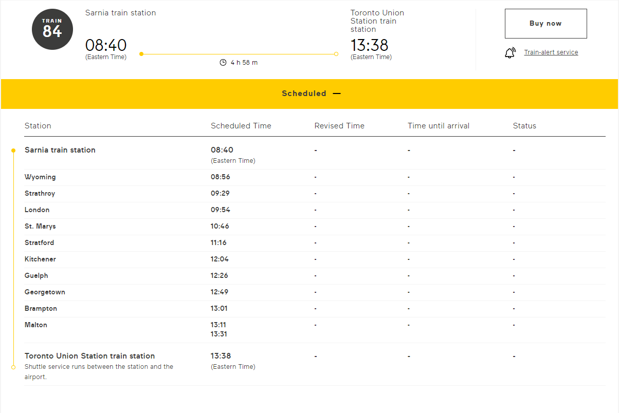

New schedule for 84 as of November 15, as discussed on groups.io:
Metrolinx’ Kitchener service is still to blame for that new schedule, even if not the London extension itself:
I am aware you are neither looking for a new job nor believing that you would be more qualified to do the job of VIA's timetablers. However, when you say that seeing #84's new schedule makes you doubt that the connections "were carefully timed", I feel compelled to point out that there hardly was any choice since there are only four gaps in the timetable which allow to sneak through Georgetown, which leaves only six slots:
  • Slot A: Operate between GO#3904 and GO#3956 (dep. Kitchener 05:09 and 06:02, respectively)
  • Slot B: Sneak through Georgetown between GO#3812 (dep. 09:30) and GO#3911 (dep. 10:35)
  • Slot C: Sneak through Georgetown between GO#3818 (dep. 12:30) and GO#3917 (dep. 13:35)
  • Slot D: Sneak through Georgetown between GO#3824 (dep. 15:32) and GO#3923 (dep. 16:35)
  • Slot E: Sneak through Georgetown between GO#3836 (dep. 21:30) and GO#3935 (dep. 22:35)
  • Slot F: Operate after the arrivals of GO#3935 in Kitchener (arr. 23:28) and of GO #3937 in Guelph (arr. 00:04)
Of these six possible slots, 2 depart Sarnia before 6am and 2 arrive in Toronto after 10 pm, which only leaves Slots C and D - and in order to allow passengers from Sarnia and intermediary stations to spend any time in Toronto, Slot C was the only plausible choice:
That said, I fully agree with you that if the infrastructure owner is unable or unwilling to provide more timetable flexibility than only two at least potentially viable slots per day, then there is little point in attempting to provide any Corridor services on that route at all. Nevertheless, the Kitchener Corridor still remains the only corridor over which fast and frequent passenger rail service between Toronto and London seems conceivable within our lifetimes...
That is the topic of a debate we are currently having at Groups.io:
In any case, the absurd lack of time windows to sneak through Georgetown is the dominating timetable constraint which dictates what is possible West of Georgetown, but with the windows being 3 hours apart and the travel time being almost exactly 90 minutes between Georgetown and Stratford, Stratford might be the only place where you could possibly meet. However, such a meet would escalate the risk of cascading trains (where a delayed westbound train delays the eastbound train at Stratford, which in turn delays the outbound GO train at Georgetown, which will then delay the westbound GO train in Kitchener) - and this might be exactly the kind of operational risk Metrolinx would be reluctant to accept...

Even without the insane timetable constraints imposed by GO's current schedule and by the skeleton state of the infrastructure West of Georgetown, I still find it unrealistic to expect the schedule of a once-daily train to simultaneously satisfy the needs of all the communities it serves along its almost five hour long journey...
As we discussed earlier (thanks @Urban Sky for the link) VIA 84 had to be moved later because with the decreasing track quality the travel time from London to Kitchener has now grown considerably longer than it was when the schedule was written. Prior to the schedule change on 15 November, it was physically impossible for the train to arrive in Kitchener less than about 20 minutes late, and the train was commonly more than 30 minutes late, causing it to block the first westbound GO train at Georgetown.
VIA tried a quick fix about a year ago by cutting the dwell time in London to allow the train to depart there earlier (thereby breaking the timed connection with VIA 70), but that was nowhere near enough. With the other constraints at London and at Georgetown, the train simply doesn't fit into that time slot anymore now, that it takes 2h12 to get from Kitchener to London.
If Stratford wants the old schedule back, they need to campaign for the track quality to be brought at least back to the level it was a few years ago when the old schedule was written. Whining to VIA will not do anything because the old schedule is physically impossible to achieve now. And it has been for a year, so surely Sharon McDonald, a "semi-regular rider" would have noticed that over the past year there was literally a 0% on-time performance with the old schedule, but with the new schedules trains are often on-time?
