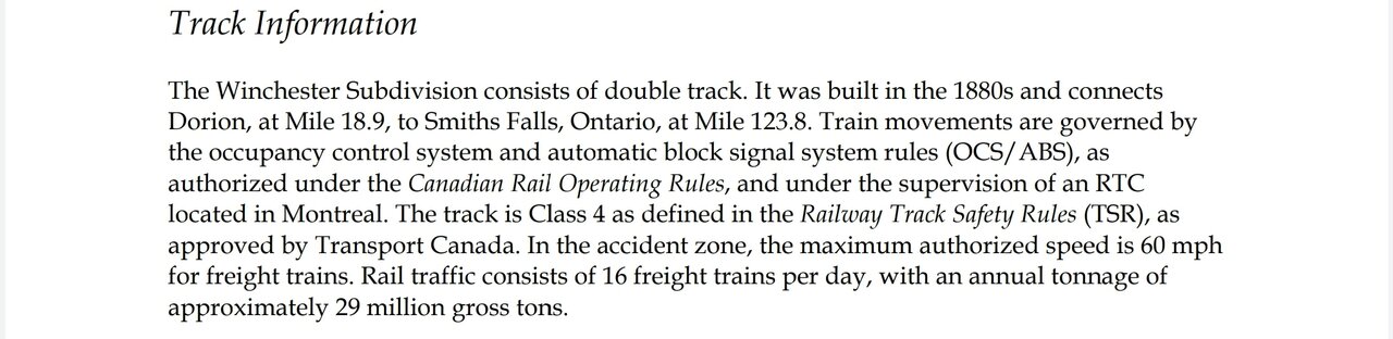

What is the track speed on the Winchester sub?
From a Railway Investigation Report in 2010:
As far as I know, CP has since decommissioned one of tracks, to save money on maintenance.
Refer back to just a few posts ago:
It isn't so much how long the passing tracks are but what percentage of the ROW still has passing tracks. According to this article, they removed
"60 miles of double track on the 104.9-mile Winchester Subdivision," so that works out to 57% (between a 1/2 and 2/3).
As far as track speeds (and especially: track Classes) are concerned, I doubt that they have improved since then...
