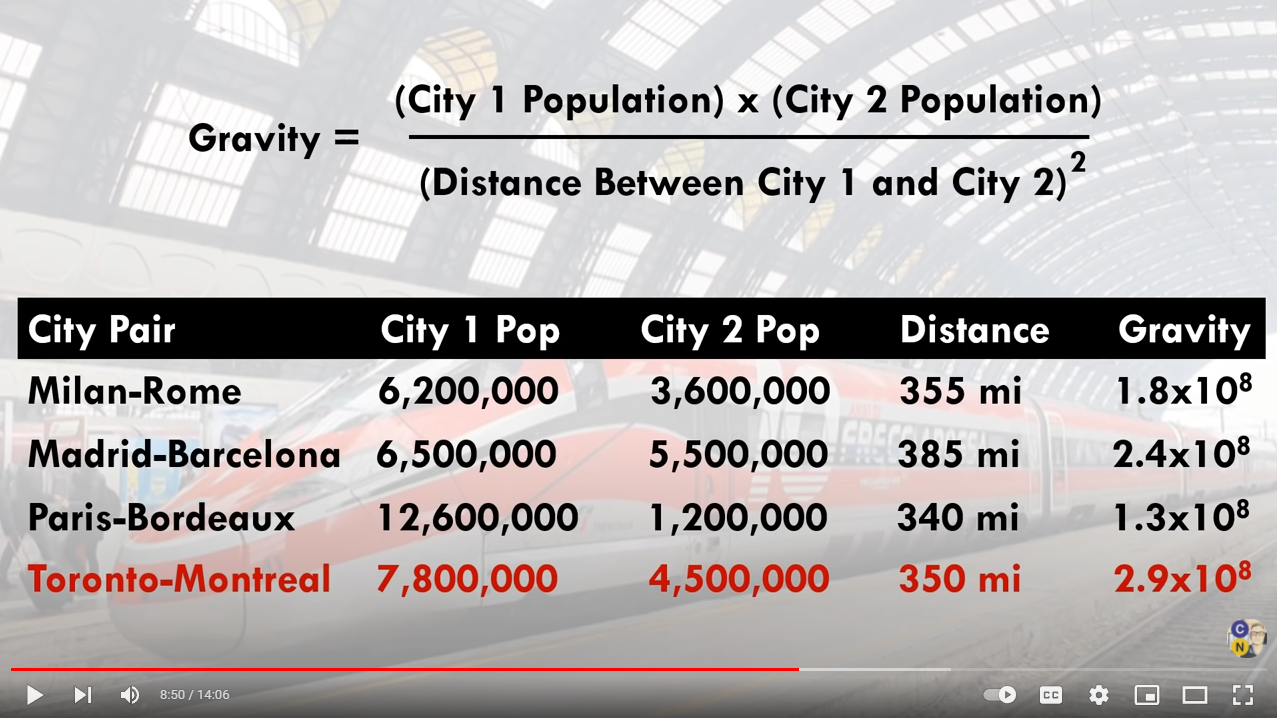

The following video was posted today on Paul Langan's "High Speed Rail Canada" page on Facebook:
While the irony of someone who boasts of having created "the only national educational resource on high speed rail, TGV, trains, past studies and current information" posting a video by a Youtuber who seemingly hasn't heard of any of the HSR studies for which Canadians are supposedly famous for was obviously lost on poor Paul, one table caught my attention:

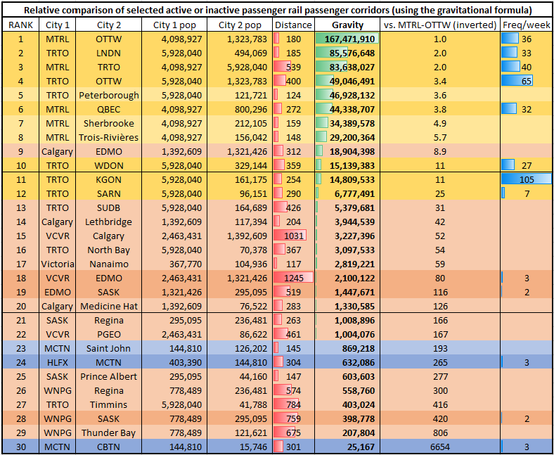

For quite a while, I have been looking for a formula to somehow compare the ridership potential of different rail corridors, this is the first time I've actually seen one and it makes sense that you multiply both cities' population figures (as the demand between two cities of 5 million people each should be much higher than between a city of 9.9 million and one of 0.1 million, even though in both cases both cities have a combined population of 10 million) and to divide it by the square of the distance by which they are apart.
I've therefore made a list of 30 (often overlapping) rail corridors, of which 11 are located in the Quebec-Windsor corridor (highlighted in yellow), 3 in Atlantic Canada (blue) and the remaining 16 in Western Canada. I also used a slightly paler color for all corridors which are not currently served by passenger rail services, which applies to 3 out of the 11 rail corridors in the Quebec-Windsor corridor, 1 out of 3 in Atlantic Canada and 13 out of 16 in Western Canada:
Compiled from: CMA/CA population figures provided by the 2016 Census, distances (in km) provided in various historic VIA/CN/CP schedules and frequencies from VIA's last pre-Covid schedule
The methodology used above has some obvious shortcomings (like using distance-by-rail rather than Euclidean distance), but while it's time for me to go to bed, I'll curiously check tomorrow what reactions and reflections this quick-and-dirty table will provoke... :)
Interesting. I presume the formula isn’t backed by any documented validation, it's just somebody's intuitive attempt at a formula?
I won’t nitpick the model - we could spend a year debating that. But taking the numbers at face value, it's certainly interesting as a discussion point.
The big takeaway for me is the huge difference in order of magnitude between the various routes.... sure, we *could* run a train Moncton-Campbellton, but is that the best place to spend investment dollars? At the other extreme, every day spent waiting to begin upgrading Montreal-Ottawa is a huge opportunity cost. Ottawa can afford that investment without any elaborate resort to investment banks, etc. so why not just do it?
The one shortcoming I see that could be addressed just by changing the presentation is how the model treats each station pair as a discrete corridor. So Toronto-Windsor stands alone separate from Toronto-London, whereas a business case for investment on that corridor would want to capture both riderships. Similarly, I have always believed that if we ever see Calgary-Edmonton investment, there should also be service (of some lesser frequency, to be sure) to Lethbridge because Edmonton-Lethbridge will have some revenue potential that isn't captured by the E-C number.
Comparing the two Montreal-Toronto options (via Ottawa, or direct via Cornwall) is interesting - same numerator, but denominators favour the direct route. But how significant is the difference?
This feels like you've opened the bag of potato chips, we've taken just a couple, and sealed the bag and put it back in the cupboard. That never lasts for long.
Similar to many statistical formulas, it is like a bikini. What it shows is interesting, but what it hides is crucial. The population and distance are important factors to the potential demand, but there are other very significant ones. Language and culture are also very important factors. The population of intermediary cities can also play an important role when looking at train service in general (though admittedly HSR trains would likely skip them anyway). It also doesn't factor in acceleration/deceleration time.
Current demand is also very important (capacity of flights + highway demand?) , and the population figure needs to be adjusted for range.
While the irony of someone who boasts of having created "the only national educational resource on high speed rail, TGV, trains, past studies and current information" posting a video by a Youtuber who seemingly hasn't heard of any of the HSR studies for which Canadians are supposedly famous...
That video was also promoted by Not Just Bikes. And the proponent of the video the thought there was no point serving Ottawa. It shows the limits of this kind of superficial analysis where one doesn't understand local geography, culture and economics.
It is worth nitpicking though; that was an exam question for a class on economic geography I took last year. This model was used as the basis for much of that field's development in the 80s but it's lack of consideration of physical and human/political boundaries severely limit its utility in it's intended case of modelling commercial trade volumes. It was never meant as a tool for designing transportation networks.
It's with noting that a key assumption of the model is that transportation cost is purely a linear function of the direct distance between points, something the clearly isn't reflective of the real world.
I'd write more but I don't have much time. This kind of psuedo-academic hot-take really annoys me but I'll withhold judgement as I haven't yet watched the video. Can also add citations later.
Still, it's an interesting basis for a thought experiment; somewhat similar to the slime mold transportation network videos...
