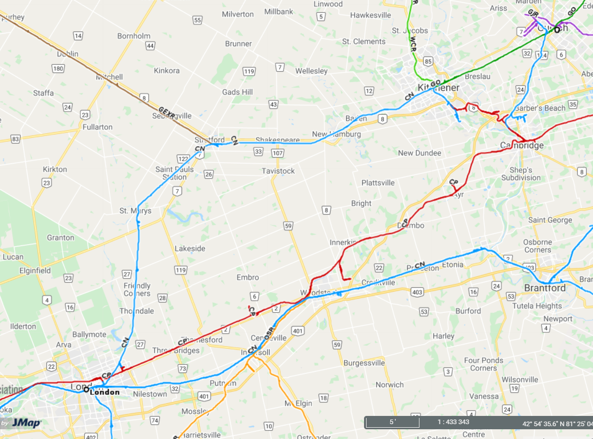

There's no readily available corridor in Southwestern Ontario they could just start building on like there is with Havelock.
There are similar opportunities to the west of Toronto as to the east.
Toronto - London
Existing railway owners:
Green = GO
Blue = CN
Red = CP
faint green = abandoned
A fantasy map of reorganized mainlines:
As others have noted, the existing north mainline is incredibly lightly-used and has a very good alignment. Obviously the main obstacle is the segment between Georgeown and Bramalea which is CN's mainline. In my fantasy map above, I showed CN being bypassed onto the Missing Link, but based on Metrolinx's statements, it sounds like frequent VIA service (~1 train per hour) might be possible without the bypass. Reading between the lines of the Kitchener Expansion business case, it sounds like even without a grade separation west of Mount Pleasant, CN agreed to 3 GO trains per hour from Toronto to Mt Pleasant, of which 1 continues through to Kitchener. If that's true, then it may simply be sufficient to build said grade separation to bump CN's agreement up to 4 trains (3 GO + 1 VIA).
West of Georgetown, far more double track would be required than is currently planned for GO's 1 train per hour base service.
And unlike going east, they would have to use so much of GO's planned RER network to get out of the GTA. So it's way more complex, than HFR. But I'm sure they'll be looking all the ideas that even we've bandied about here.
The Kitchener line is currently being quad-tracked through the busy central portion, so as long as GO organizes their services onto separate "local" and "express" tracks, VIA should have a pretty clear shot through the GTA.
And eventually, they'll have to cut a large cheque to CN to hand over the sub between Guelph and London.
Metrolinx bought the 53 km segment from Kitchener to Georgetown for $76 Million in 2014. That's $1.44M per km, which is the equivalent of $1.59M today. So at that rate, the 92-km segment from London to Kitchener would cost $146M.

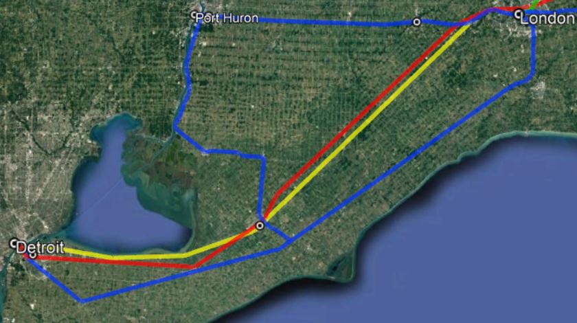

London - Windsor:
Yellow = VIA
Blue = CN
Red = CP
A fantasy map:

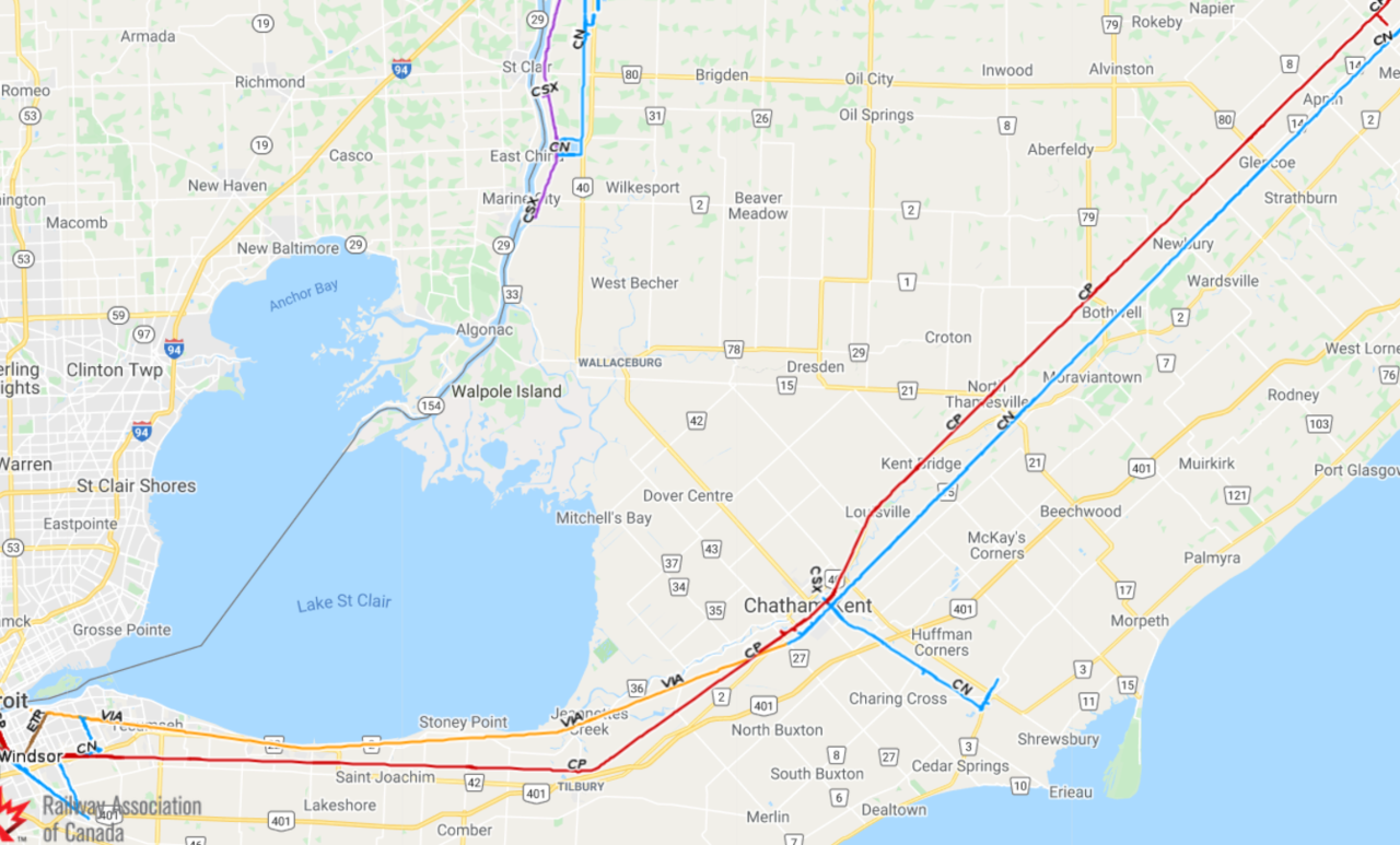

London - Windsor:
Yellow = VIA
Blue = CN
Red = CP
A fantasy map:
Unfortunately the whole of the former CASO has been ripped up, and the track north of Chatham are also idled and overgrown. However, there plenty of capacity for CN and VIA to share the Chatham Sub, unless the plan becomes to reconnect service to Detroit and Chicago, in which case the alignment along the CP corridor west of Chatham recommended by David Collenette is much better than the apparent proposal in the Amtrak Connects US plan to use the ETR to get from the tunnel to Walkerville.
