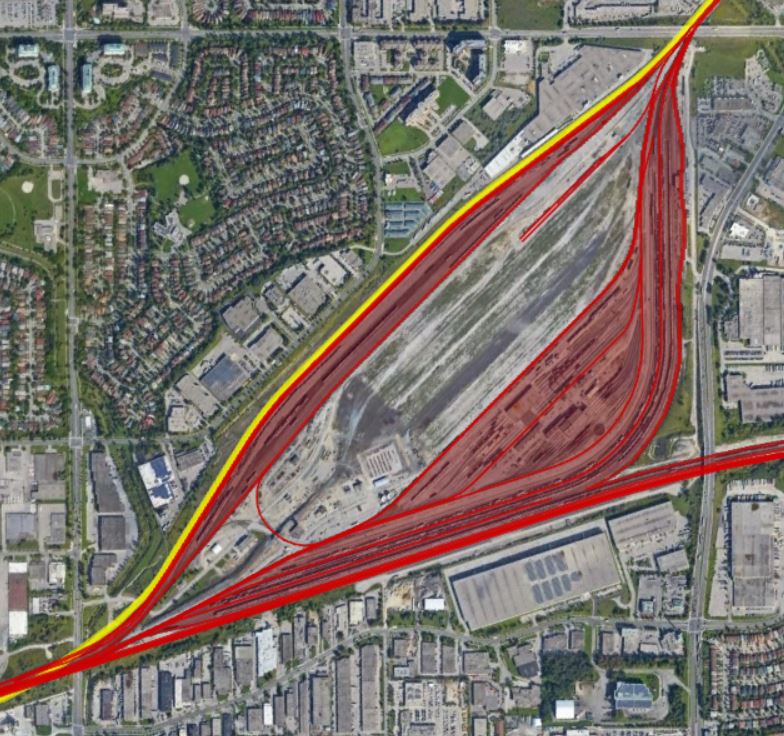

There is now plenty of room to build a dedicated main line track for HFR skirting along the north side of the Agincourt Yard. It will be interesting to see how a connecting track would be built to reach the Stouffville line. Curvature will be tight, which means trains will have to run slowly. Ideally one would have an underpass under the CP line, but that's expensive and could take time to build. If the connecting track isn't an underpass, it will have to cross CP's freight line at grade, similar to how VIA transits Smiths Falls at the moment. That's a recipe for CP to undermine the whole premise of improving reliability by removing conflict with freight...... doubly so if VIA intends to carry on along the Belleville Sub to Leaside and down the Don Branch. And if VIA does choose the GO line, trains will cross over at grade to join that line....inevitably this will conflict with GO movements. All doable, but the useable high speed portion of the line will likely end around Tapscott.

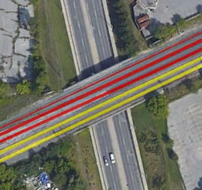

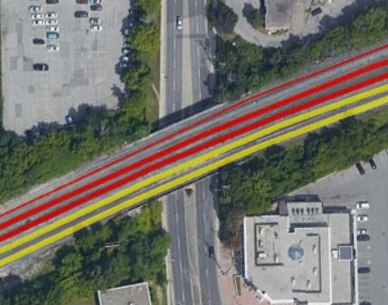

The next three road crossings (Midland, Sheppard, and Brimley) have 5-track overpasses, which leaves room for 3 tracks for CP (or 4 if VIA only uses 1 track).

Like you said, it shouldn't be a problem to carve a ROW out of the west side of the CP yard, since any lost tracks could be replaced using the giant empty space where the hump yard used to be.
