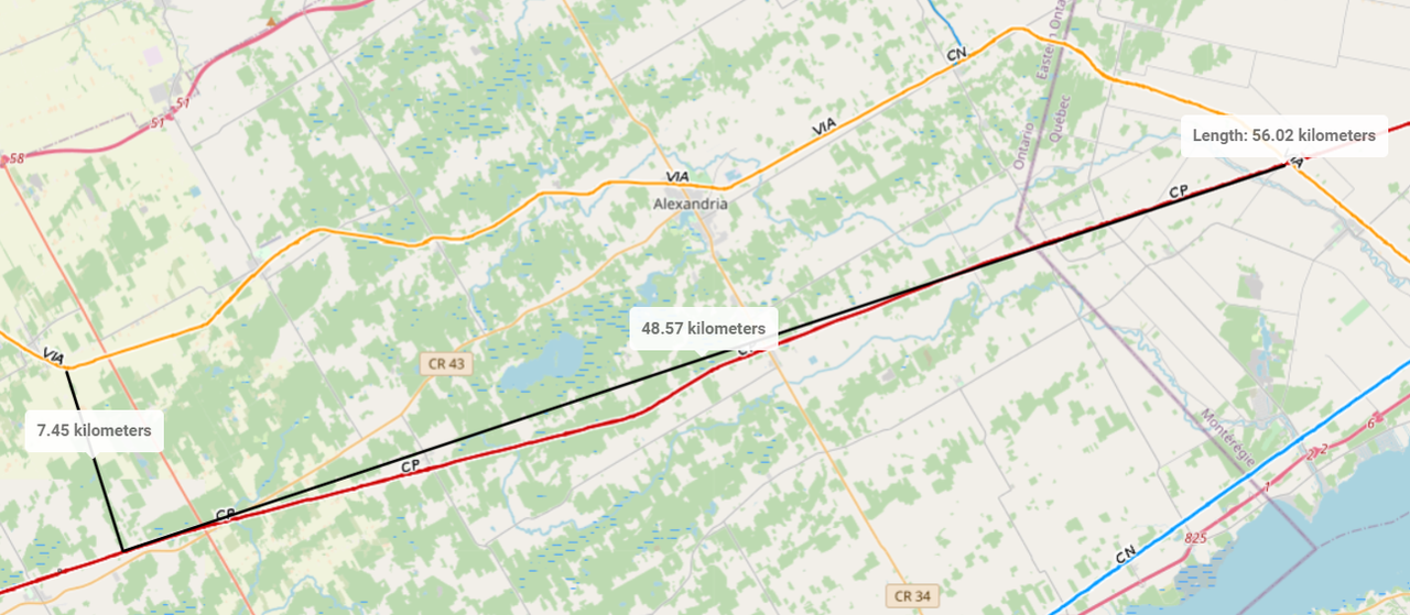

Interesting analysis, even if it is a strawman argument. You said, "for the segment you want to bypass (i.e. De Beaujeu to Smiths Falls)" yet I never said anything about De Beaujeu. In fact, I said:
While using the Winchester Sub would technically be an option, I don't think it is a very likely one given that I don't think CP would be willing to have their network disconnected from the Atlantic ports.
If I wasn't suggesting the use of the Winchester sub, I am not quite sure what other bypass route you had in mind that would extend all the way to De Beaujeu. One of the other problems with using the Winchester sub form De Beaujeu as a bypass, is it runs parallel and within 7.5 km to VIA's own Alexandria Sub for almost 50 km. It seems kind of a waste to me. Better to have trains to/from Ottawa use the same track as the Toronto-Montreal trains whenever feasible.
As I said before, I do agree that for HFR, an Ottawa bypass doesn't make sense. When we are ready to upgrade to HSR (and demand warrants it for high frequency on both routes), things change, but not because the route is shorter, but because the train won't have to slow down for Ottawa. Even if there was the political will to have trains drive through Ottawa station without stopping, they would still have to slow down for the curves in and out of the station, which could be tough to upgrade. As a result, ignoring any extra distance traveled, I could easily see a 20 minute time savings (if not more) from avoiding speed reductions alone, ignoring any additional distance (50 km at 300km/h is 10 minutes instead of 30 minutes at a 100km/h average speed over the same distance). When you take that into account, you realize that the bypass doesn't even have to take the shortest route, but could be further north to maximise the amount of shared track. The key is the bypass needs to be faster, not just shorter.
Since strawman arguments seem so popular on this forum, I will say this again, none of this is feasible until there is demand for at least 15 trains a day on each of the Toronto-Montreal, Toronto-Ottawa and Ottawa-Montreal routes and VIA has the money to upgrade HFR to HSR.
