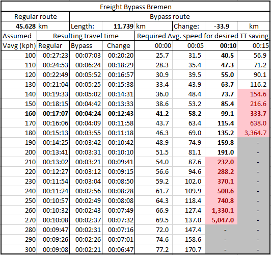

To explain this, let's look at an actual real-world example of the Bremen Freight Bypass:
Bremen Freight Bypass [...]
When the Hamburg-Venlo railway was built, the Hanseatic city of Bremen (like Hamburg) was still not a member of the German Customs Union (Zollverein); in fact this did not happen until 1888.
In order to be able to transport goods from the Rhenish-Westphalian industrial region to Harburg [Note: Harburg is a suburb of Hamburg] without incurring taxes in the German customs area a treaty-approved goods line was built due east past Bremen which also reduced the journey time considerably because it was almost 13 km [Note: more like 34 km, the bypass itself is just short of 13 km] shorter than the main route which ran in a loop through Bremen state territory.
[...] The shortcut was worked for several years by the Hamburg–Cologne Metropolitan line. Currently an ICE Sprinter pair of trains uses the line to circumvent Bremen Hbf. Tracks pass over the Friedenstunnel in Bremen.
Basically, an 11.7 km long bypass (from Sagehorn to Bremen-Gabelung) avoids a 45.6 km long trip through Bremen (Germany's 11th-largest city and smallest city-State with just over 500k people), thus shaving 33.9 km off the route or 2.9 km for every km bypass built:
Adapted from: DB Netz Register of Inftastructure
Note that out of 21 intercity (IC/EC/ICE) trains running daily between Cologne and Hamburg, only 6 make use of this bypass, whereas 15 trains (i.e. one per hour) use the regular (longer) line to serve Bremen Central Station:
Source: Fernbahn.de
Consequently, the Bypass line is unlikely to be upgraded beyond its current speed limit of 100 km/h (even though the regular line is capable of 120-200 km/h), as even at an assumed average speed of 160 km/h on the regular line (a unrealistically high estimate!), an average speed of 100 km/h on the bypass route would save exactly 10 minutes, whereas even an upgrade to 300 km/h (the fastest speed of any train reached in Germany while in revenue service) would fail to save another 5 minutes):
Note: speed figures highlighted in red means that the average speed required to achieve the desired travel time saving exceeds the average speed assumed for the regular route.
