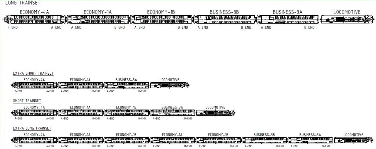

Nice work! I hadn't realized that the trains would be arranged in different lengths. I thought I'd read somewhere that they would all be 5-car semipermanently-coupled sets, but I guess not.
It's interesting that the standard 5-car set is called "long", because:
- it's the standard length
- I don't think 5 cars is long by any standard
- it doesn't leave a name for a theoretical 6-car set

Continuing my analysis from yesterday, if we assume quantify of each new trainset that I posted, VIA would be using the following quantity of each train and car type:
SizeQtyBusiness 3ABusiness 3BEconomy 1AEconomy 1BEconomy Cab 4ATotal
Extra short1101013
Short1313013131352
Long11111111111155
Extra long33366321
Total282814313028131
Spares41812429
Assuming they buy 32, long trains (and thus 32 of each car type), they would end up with 18 spare Business 3B cars and only 1 spare Economy 1A and 2 spare Economy 1B cars, and this is with using only 3 extra long trainsets. As an opposite extreme, if for the Long trainsets that resulted in a significant reduction in seats (HEPII Set 3 and LRC Sets 1, 2, 3, 5, 6, 7 and 15), they used Extra Long Trainsets instead, the quantity of each train and car type used would change as follows:
Extra short1101013
Short1313013131352
Long33333315
Extra long11111122221177
Total282814393828147
Spares418-7-6413
As you can see, in terms of the total number of cars available, they are fine, but they are short 13 economy cars (7 x 1A and 6 x 1B), yet still have 18 extra Business 3B cars. I know some will argue, VIA could just substitute Business 3B cars on those trains, but as @Urban Sky previously said,
If you don't have different Economy or Business non-cab car types, you would be forced to have accessible facilities (accessible washroom and two wheelchair spaces) as well as galleys in every single car, which would result in a lower seat count...
I don’t know which of these features a Business 3B car will have, but it is quite likely that by substituting those for the Economy 1A and 1B cars, it is probable that they would end up with a shortage of certain required amenities, for the length of train in operation.
It is very likely that the cost to build either type of economy car would be very similar to the cost to build a business car (yes there are more seats, but economy seats likely cost less than business seats), especially when considering the total cost of the order. This is of course assuming the change request is made early enough in the order process. Once Siemens has started ordering materials, or worse, begun construction, the cost would grow significantly. I would hope that VIA has already done this based on their projected needs.
Now I don’t expect any of this to reflect what VIA actually wants or needs as much of what they are currently running is likely a compromise based on what they have available to them. This new fleet purchase is a chance to start from a clean slate and buy what they actually need going forward based on projected ridership. This is just to show examples of what could be done.
^I may have lost the thread on why there have to be two variations of Coach and two of Business Car, but taking that as read, it's apparent from the extra short version trainset that "A" cars are all that is needed to equip a trainset with all the prerequisite accessibility, technology, and service delivery equipment. The "B" cars may augment that, but one assumes that the "master" version of everything important is in the A's, and the "B" cars are fill-outs.
That leads one to think that the "B" cars ought to be generic and most easily convertible from one configuration to the other. So, if the distribution were found to be sub-optimal, it would be most practical to shift from Coach B to Business B or vv.
So long as that's roughly true, then I wouldn't worry about getting the initial distribution exactly right. Changeovers will be pretty doable.
One has to think that the chair frames will use common components, even if the cushions and backs differ. One hopes that moving between 2-2 and 2-1 seating doesn't require rebuilding anything structural, and wiring etc is compatible. I expect Siemens and VIA will have thought this through.

I don't know if the configuration of any of the cars is publicly known, but if I had to guess (it is just a guess), the special features of each type are as follows:
Car typeClassServicesTrainsets
1AEconomyGalleyAll (2x Extra Long)
1BEconomyAccessible (+ bike rack?)Short, Long & Extra Long (2x Extra Long)
3ABusinessAccessibleAll
3BBusinessGalleyLong & Extra Long
4AEconomyAccessible, CabAll
This would mean:
  • The Short and Extra Short trains would have the business car use the Galley in the 1A car (presumably at the front of the car) and there are accessible seats and washrooms available in both classes of service (the short would have a second economy accessible car).
  • The Long train would have separate galleys for business and economy and the same number of accessible cars as a short train.
  • The Extra long train would add a second economy galley and a third economy accessible car.
This would allow the appropriate service growth as the train gets longer. If my guess is correct. the 3B could be considered a replacement for a 1A (though the galleys might be configured differently) but it wouldn't be a replacement for 1B.
Given that the seating in business class is 2+1 but in economy it is 2+2, there is a good chance that the seats are wider in business class. The common areas would also likely be different as the washrooms might be appointed differently and fewer passengers means they may need less luggage space. The wiring for task lighting and power outlets would also likely be different for the different number and configuration of seats. So while the shell might be the same, there are likely significant differences to the interior, which would make conversion a bigger job than just buying some extra seats and reupholstering the existing ones.
That is certainly my hope. The fact that VIA has published diagrams (albeit low resolution) of the different car and train configurations, I expect they have been having a lot of discussions behind the scenes.

Image From VIA Rail's Website
