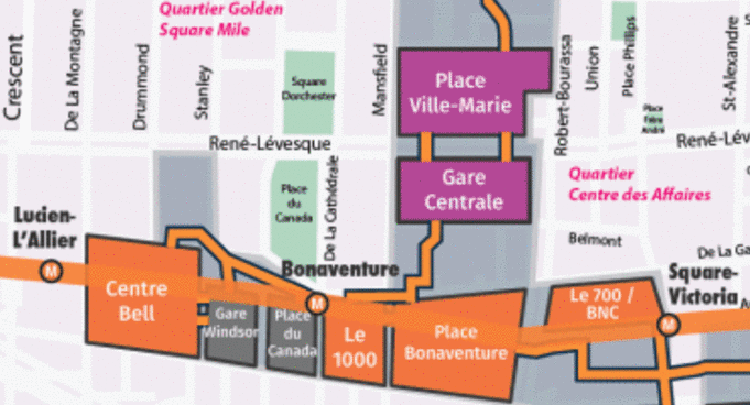

Underneath the Gare Centrale are streets (Rue Saint-Antoine, Saint-Jacques, Notre Dame) and then the various arms of the Ville-Marie Highway tunnel, which make the construction of an underground station an insanely expensive fantasy. if you refer to my post from August 2019 (to which you even reacted):
So what about going above or below the current ROW? Above, forget it, as there are buildings on top of Gare Centrale and the green line above the existing Mont-Royal tunnel (refer to the picture of McGill station further above).
As for going below the current ROW, there is the slight problem that the Autoroute Ville-Marie (think of the Gradiner Highway, but well hidden in a tunnel) happens to be the most complex just at the eastern end of Gare Centrale:
1564844867731-png.197448
Adapted from: World Road Association
Just to give you an idea of how deep you would have to dig to avoid the Ville-Marie and Viger tunnel complex, it reaches until 42 meters under street level only 200 meters north of where VIA passengers leaving Gare Centrale view the daylight for the first time (exact location here):
1564845604720-png.197449
Source: World Road Association
And we haven't even touched the question of where and how you want to build a full-size intercity terminal railway station anywhere underground and near Gare Centrale...
Building a new station which is completely disjointed from existing rail networks (exo, VIA, REM, Metro) is a complete non-starter. It’s already bad enough with the distance between Gare Centrale and both Metro stations (Bonaventure on the orange line and McGill on the green light), but at least if is accessible...
