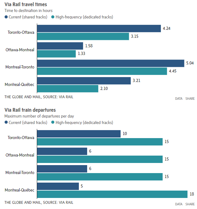

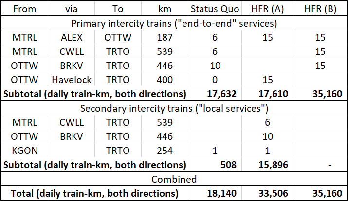

Let's compare both approaches and assume that HFR means 15 frequencies (i.e. round-trips) per day on all primary markets (i.e. MTRL-OTTW, MTRL-TRTO and OTTW-TRTO), as suggested by this graphic released by the Globe and Mail:
Source: Globe and Mail (2019)
In the case of operating one single HFR route, operating 15 MTRL-OTTW-TRTO round trips to serve the end-to-end markets has virtually the same train-mileage as the Status Quo (i.e. 6 round trips each MTRL-OTTW and MTRL-TRTO and 10 round-trips OTTW-TRTO). Conversely, operating 15 round trips each on all sides of the triangle exactly doubles your daily train mileage. Granted, you would still have to operate some Local services with the "single HFR corridor" approach, but even if you operated all the current Lakeshore frequencies (i.e. in addition to the actual HFR services), your train-mileage would still be slightly lower than with the "HFR on all sides of the triangle" approach:
Maybe the above explains why I have such a hard time imagining how HFR over the Kingston Sub could possibly be more viable than over the Havelock Sub (and how any such proposal could be made acceptable to CN)... ;)
What's the difference between HFR(A) and (B)?
