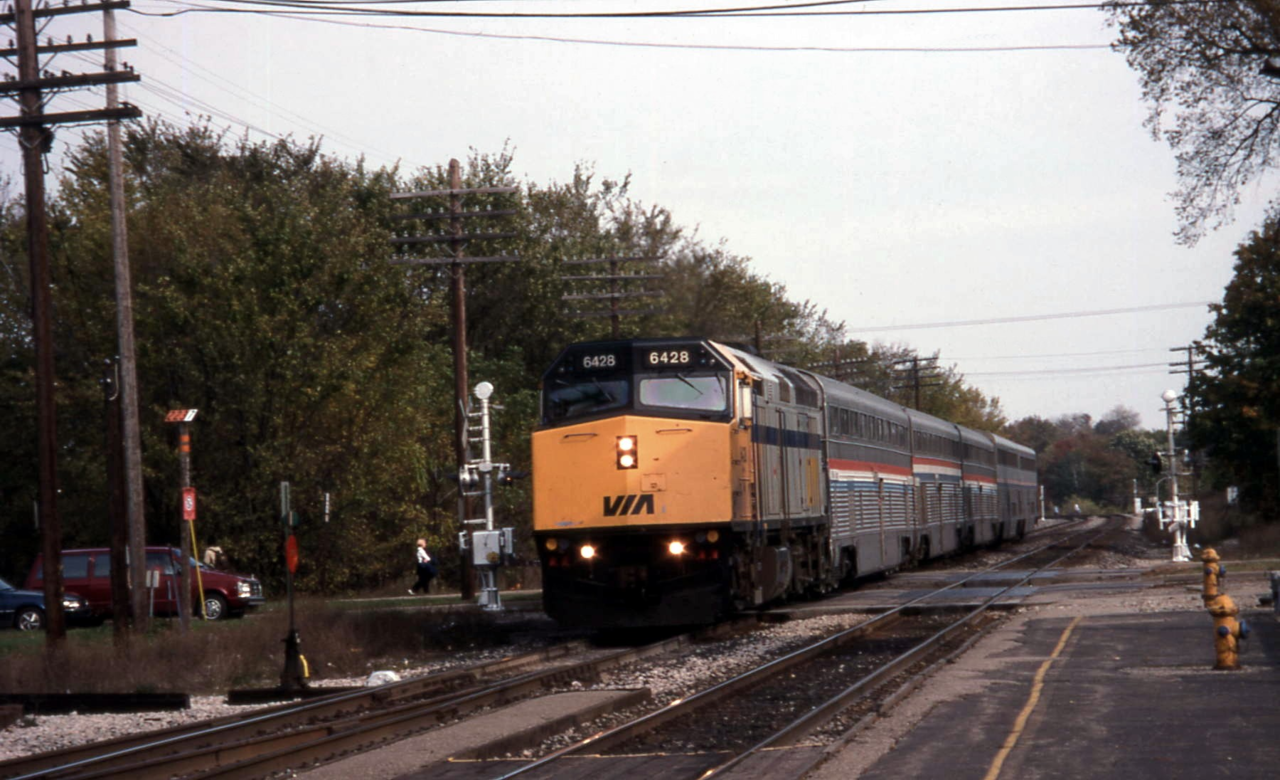

The cars are taller than the Superliners which already have enough potential sizing headaches on VIA's network.
The cars don't fit into the trainshed at Winnipeg, and probably don't fit into the trainshed at Union - which complicated operations when the cars were deadheaded across on the Canadian for work.
Would Superliners fit in the trainsheds at both Winnipeg and Toronto's Union Stations, or is that what you mean by "already have enough potential sizing headaches on VIA's network?"
^ I think Superliners were used for the Chicago to Union trip before it was canceled? So if my memory is correct then I assume they would. I think I read earlier in this thread the Winnipeg shed is lower than Union's?
Update: I checked Wikipedia and it provided the picture below and this article.
...which leads us to the incident which caused the withdrawal of the Superliners from that route:
