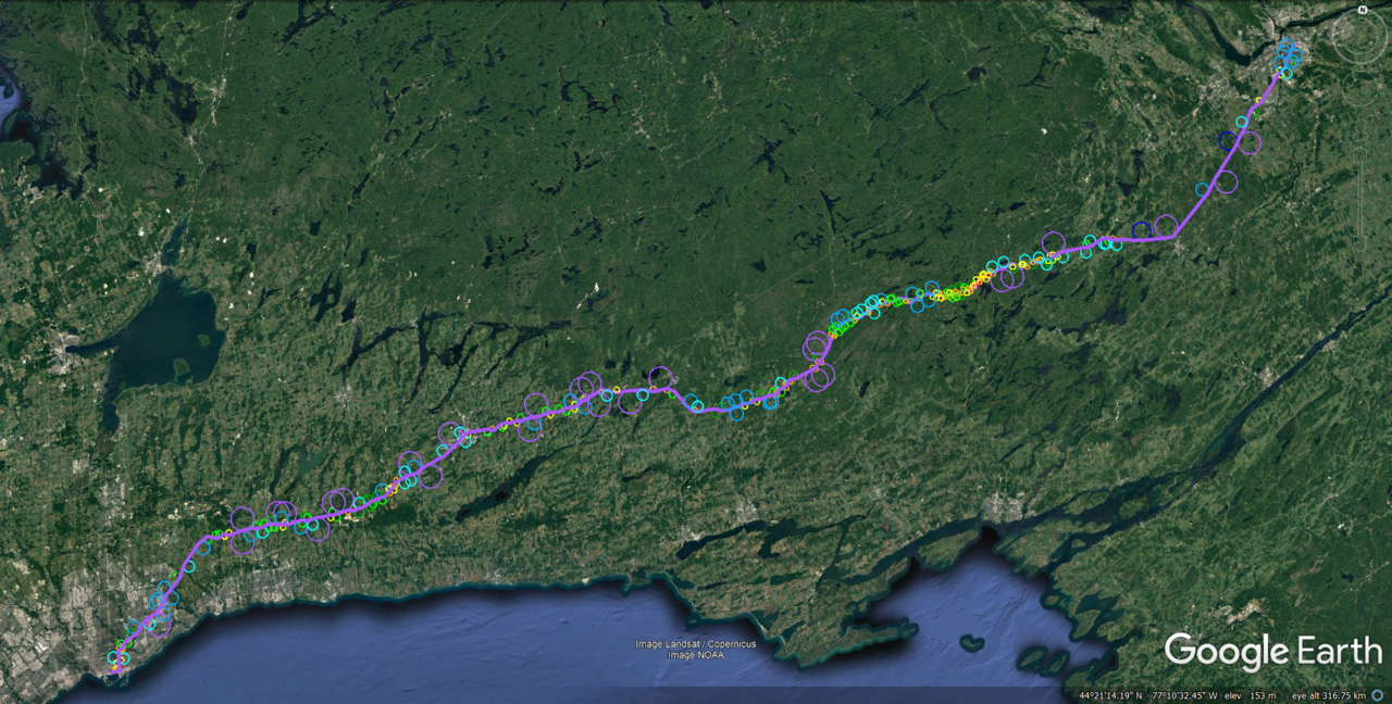

I was getting impatient waiting for the HFR report, so I decided to do my own armchair analysis.
The whole description ended up being pretty long so I just posted it on my blog here: https://ontariotrafficman.wordpress.com/2020/08/17/mythbusting-vias-hfr-travel-time-claims/
but here's the summary:
These are the segments which appear to be upgradeable to 110 mph operation using curve widening and some relatively feasible realignments.
The biggest challenge is the 102 kilometres between Kaladar (east of Tweed) and Smiths Falls.
For the 87 kilometres from Kaladar to Glen Tay (just west of Perth), the line traverses rough rocky terrain dotted with lakes. As a result, the line follows a meandering path with frequent tight curves, with a radius of about 550 metres. This would only allow speeds around 80 km/h (50 mph) or so. Basically none of the existing ROW is useable for 110 mph operation since the curves are too close for the realigned route to rejoin the existing ROW before the next curve.

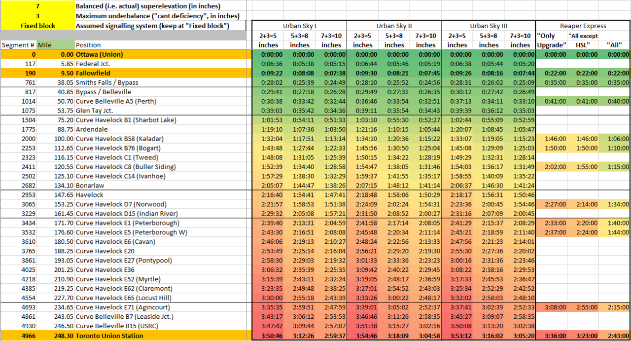

To get an order-of-magnitude estimate for travel time, I assigned a speed for each segment and simply calculated the travel time at that speed. This provides the theoretical minimum travel time given those speed limits. It is not possible to achieve this travel time in the real world because it does not account for acceleration/deceleration, miscelaneous slowdowns (e.g. through switches), stops (stations, meeting trains in the opposite direction) or schedule padding.
The speed limits in the slower segments were roughly based on the radius of existing curves, except for the segments within Toronto and Ottawa, which are based on existing GO Transit and VIA Rail schedules, and within Peterborough where I assigned a 50 km/h (30 mph) limit due to the numerous awkward level crossings.
I examined three options, which include varying degrees of new alignments. The first scenario only upgrades the easiest segments. The second scenario also fills in the gaps around Havelock and around Tweed. And the third scenario adds in the big-ticket item: a new 102-kilometre high-speed railway from Kaladar to Smiths Falls.

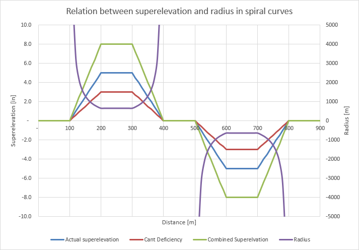

First off, I have modelled the travel times for 5, 8 and 10 inches of total superelevation (i.e. actual and unbalanced superelevation combined) in three iterations for each:
  • In my first set of calculations (called "Urban Sky I" in above table), I had ignored the problem of reversed curves ("s-curves").
  • In my second set of calculations (called "Urban Sky II" in above table), I had tried to somewhat approximate the combined transition length of a reverse curve and then work out the maximum level of superelevation to maximum the speed allowed after respecting the requirements for transition lengths and tangent lengths.
  • In my third set of calculations (called "Urban Sky III" in above table), I only measured the tangent track between the curved sections of reverse curves and then set the maximum speed so that the spiral lengths would not exceed the length of the tangent track (i.e. the "straight segment") in between the reversed curves.
Even though the second approach closer resembles in real-life, it is impossible to measure a spiral length with the tools available in Google Earth plus, as the radius of a transition curve changes from infinity (where the track starts curving) to the radius of the main part of the curve), as shown for a hypothetical spiral curve (with a radius 650 meters and a maximum allowable speed of 65 mph) below:
Source: own work
Note: tangent track sections are where the superelevation is zero and transition sections are where the radius and superelevation change.
Consequently, it was more practical to only measure the transition lengths and to arbitrarily set the superelevations (balanced and unbalanced) in a way that the resulting spirallengths would not exceed the transition lengths, which is why I set the superelevation values to a balanced (actual) superelevation of 5 inches and a cant deficiency (unbalanced superelevation) of 3 inches, because 5 inches of actual superelevation requires a minimum spiral length of 96 meters, while 3 inches of cant deficiency in combination of a maximum speed of 65 mph requires a mimimum spiral length of 97 meters.
I refer to Part 3 of my "modelling travel times for the Havelock alignment" exercise if anyone struggles to make sense of the above, accompanied by the following excellent video by Gareth Dennis (a UK-based railway engineer which also teaches at university and an enthusiastic audience through his Youtube channel):
Long story short, I simulated travel times between 3:50 and 3:55 for 5 inches of total superelevation, between 3:12 and 3:19 for 8 inches of superelevation and between 2:59 and 3:06, which suggests that the (previously or currently) existing alignment of the Havelock route might at least theoretically allow a travel time of 3:15:
Compiled from: own calculations with geographical and track alignment data approximated with the help of Google Earth

We will of course need to add some more of the "real-world factors" you mention, but I will of course share my spreadsheet with my calculations with you and @crs1026 in the next few days so that you can add a few more constraints and fix some of the shortcomings, such as:
  • The acceleration and deceleration capabilities of the electrical trainset I had selected for my Master Thesis (and thus also for this exercise) may exaggerate the capabilities of VIAs future (fuel-operated) fleet
  • Local speed limits (in addition to those imposed by track geometry) might apply when traversing built-up areas such as around Ottawa, Peterborough and Toronto
  • Tracks shared with freight traffic might permit only lower levels of superelevation than those which will be dedicated to passenger trains
Afterwards, you will also be able to estimate how much realignments are needed to get the travel time back to 3:15...
Source: own work
