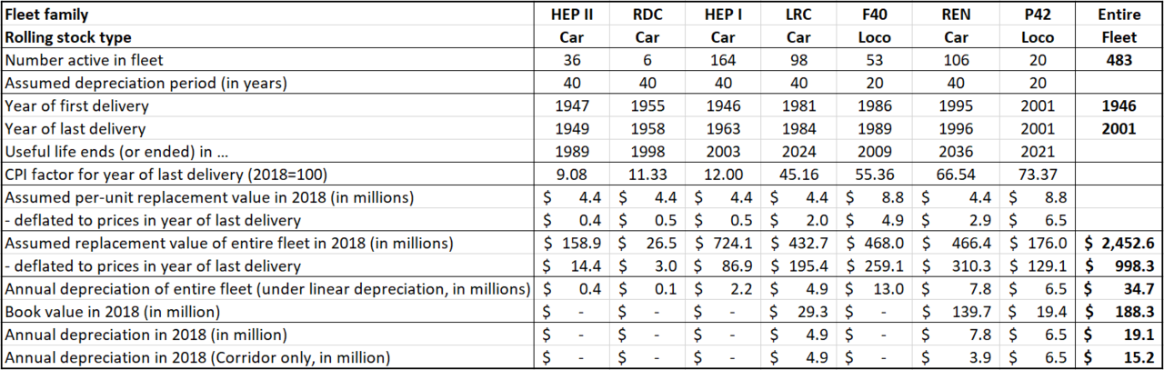

Okay, let's crunch the numbers. My assumptions are the following (if you happen to disagree with any of them, it shall be your obligation to present a better one):
  • Linear depreciation (which is the accounting practice adopted by VIA, see page 90 of its 2018 Annual Report)
  • Depreciation period of 20 years for locomotives and 40 years for cars (note that Amtrak's average fleet age is 21 years for locomotives and 31 years for cars)
  • The replacement value of each of VIA's current fleet type is to be calculated by deflating the unit cost of its new Siemens fleet to the value of the year in which the last year of that fleet type was delivered (ranging between 1949 and 2001)
  • It is assumed that the unit cost of a locomotive is twice that of a car
  • To calculate the unit cost, it is assumed that the $989 million contract with VIA covers 32 trainsets and that every set includes 1 locomotive and 5 cars, for a total of 32 locomotives and 160 cars
  • Consequently, the assumed replacement values would be $4.4 million for a car and $8.8 million for a locomotive
This means that replacing VIA's entire active fleet would cost approximately $2.5 billion, but that when adjusting the replacement value of the various fleet types to the respective years where they were purchased, the initial fleet value decreases to $1.0 billion. Correspondingly, the annual depreciation would be $39.3 million, but note that 4 out of the 7 fleet types (HEP II, RDC, HEP I and F40) would have only a nominal book value (maybe $1), as they have already exceeded their assumed useful life. Therefore, the combined book value in 2018 of VIA's active fleet would have been only $188 million in 2018, which translates to an annual depreciation of $19.1 million:
Compiled from: Fleet counts and delivery dates provided in the CPTDB Wiki, combined with data mentioned in the assumptions stated above this table
This back-of-the-envelop calculation suggests that VIA's annual fleet depreciation costs are $19.1 million for its entire fleet and $15.2 million (if we assume that half of the Renaissance fleet is allocated to the Ocean rather than the Corridor) for the Corridor. As I've explained in Post #6,890, VIA Rail's 2019-2023 Corporate Plan shows a contribution of $77.0 million for the Corridor and of $39.2 million for the entire network. This means that the Corridor's contribution does not just offset the negative contribution of the non-Corridor routes, but also the depreciation of VIA's entire fleet. This is why I insist that VIA's current Corridor operations recover its costs and that it is just the overheads (like the salaries of HQ folks like me) which make it require an annual subsidy.
Therefore, the resale value of VIA's fleet doesn't matter as the Corridor fleet reduces VIA's subsidy need rather than increasing it. Nevertheless, the list prices you quoted only reveal the price at which railroads or rolling stock owners are willing to sell their equipment, not whether there is actually a market at that price (or at all). Given that VIA has repeatedly declared that its fleet has reached the end of its useful life and that it is in dire need of replacement, I wonder what kind of railroad or private car owner would possibly purchase such worn-out cars...

Okay, let's crunch the numbers. My assumptions are the following (if you don't like any of them, it shall be your obligation to present a better one):
Thank you for completing an insightful analysis of the depreciation of VIA's corridor fleet. There are two key reasons why I did not perform an analysis with as much depth as yours:
I gave you formulas rather than hard numbers because of the many cars have gone through maintenance programs to extend their lifespan. These programs need to be depreciated (as indicated on page 90 of the 2018 annual report). There is limited public information regarding the cost or lifespan for many of those programs. However, they certainly do increases fixed costs through depreciation. By selling the equipment, VIA would face a one time gain/loss on disposal, but wouldn't incur any further depreciation costs on the fleet in the following years.
I'm skeptical of using of the shelf life spans because they don't always indicate the actual lifespan of a piece of equipment and the assumed depreciation period. The LRC's, for example, had an expected operating life of 20 years. Which was extended by what will supposedly be another 20 years (although I'm hearing that the post-ISRI ones didn't get a full overhaul). There were too many uncertainties for me to do a full analysis with the public information available to do an accurate analysis. However, I'd be happy to complete a full analysis if/when I receive the data/time to complete it.
