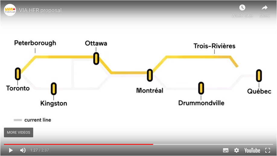

Having said that, the way Via has advertised it's HFR strategy has either been very poorly planned or very poorly explained/marketed.
Their communications say that they would only be building new, passenger-only tracks along that mostly abandoned that Toronto⟷Peterborough⟷Ottawa corridor, depicted in the yellow line in the above screencap, and not along the lakeshore corridor, or from Windsor⟷Toronto. This is just ridiculous.
TPO would become a point-to-point link trying (and probably failing) to compete with air traffic YYZ⟷YOW as it appears to only be Class 3 rail with 60mph (97km/h) speed limits that they seem to be talking about building. or at least nothing indicates class 4, 5, or 6 tracks. I'm skeptical about its potential ability to draw new riders, and I think the money would be better spent on remediating existing track and widening existing corridors to add tracks and reduce contention that way until ridership is such that it is obvious new freight corridors need to be built to remove contention completely. At this point in time, I am more sanguine about GO producing results even under PC cutbacks, than I am about VIA's HFR.

The "TPO" route will be Class 6 rail at portions rebuilt by VIA, with a maximum speed of 177km/h, because of at-grade crossings.
VIA does not own the corridors or the tracks for the current route, CN does.There is little to nothing they can do. An attempt in the 00's to add passing track/sidings for passenger lines on the existing route was both extremely costly, and futile, as CN both had to be paid to do the work (its their corridor) and overcharged, and lengthened their trains to make them unable to fit in the sidings, which were built to allow VIA trains to pass.
CN owns the corridor, the tracks etc, its their mainline, and they have little to no incentive to give VIA the right of way.
Its a non starter, and thats why the HFR route was chosen.
However milk-run service will continue along the CN corridor to those communities.
Where have you seen that? Nothing I have read from VIA has indicated that would be the case.
And if Ontario/Metrolinx can get CN to agree to additional tracks in a CN corridor, as seems to be the case for 2WADGO on the Kitchener line, there's no reason why that cannot happen for VIA. Especially if Via buys the land where the corridor needs to be widened.
