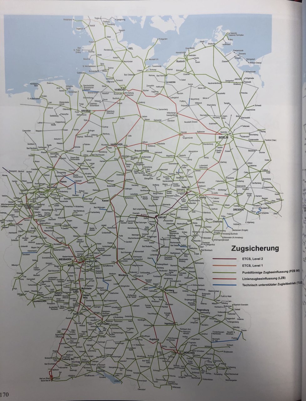

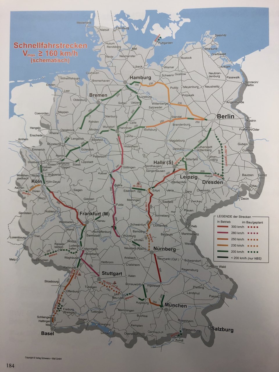

I agree that the rail system in Germany is impressive, but this would make you a time traveller, because the upgrade of the Dresden-Berlin line to 200 km/h is only planned for 2021...
...as anything beyond 160 km/h would require the installation of LZB or ETCS, as PZB with its stationary signals is limited to 160 km/h:

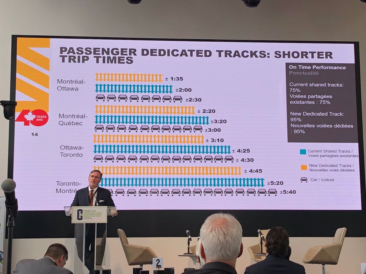

For reference, here are the projected HFR travel times vs current vs automobile.
Quoting this again as a reminder of what the projected travel times are. Every segment will be competitive with driving from downtown-to-downtown. 3 of 4 will be pretty competitive with air. If they can achieve that for even double the projected $4 billion budget, that would be impressive.
Toronto-Ottawa at 3:10 is pretty strong. With the new LRT, it would be 3.5 hrs from Union station to downtown Ottawa. It's about 2.5 hrs for the same with Porter. And if you're traveling from the eastern 416 or 905, HFR wins. No contest.
Likewise, HFR will take a chunk out of AC's Montreal-Quebec City flights. 45 mins gate to gate. But in both cases you have 15-20 mins of traveling to the airport in traffic. Add in pre-boarding time and the train looks really competitive.
Ottawa-Montreal effectively is commutable.

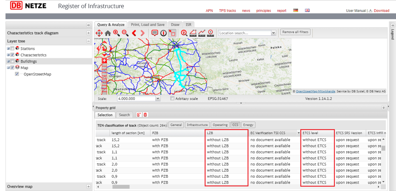

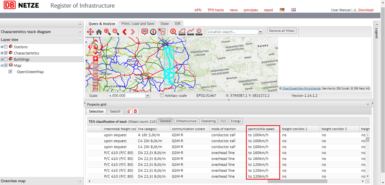

Go on Deutsche Bahn's Register of infrastructure (requires Java Script), click on the "Select by rectangle" option, select the same area as in the screenshot below (Berlin is exactly at the top left of that rectangle, whereas Dresden is at the exactly opposite corner) and scroll to the right until you've reached the "permissible speed" column and then scroll down until the last object:
195192
You will not find a single object with a permissible speed beyond 160 km/h (i.e. the maximum speed for PZB), because none of the segments has been equipped with LZB or ETCS, which are the only train control systems which are certified in Germany for operations beyond 160 km/h:
And this is why I find your praise of track segments which have been upgraded "to HSR standards" so ironic: because the line you were presenting to us as a role model of what you can do when you go beyond HFR (i.e. towards HSR), is in reality exactly between present-day VIA's corridor services and what HFR promises to deliver in the future - with a maximum speed (160 km/h) of what you call "standard VIA speeds", a minimum travel time (1:46) representing an average speed which is (very marginally) surpassed (111.51 vs. 111.90 km/h) by present-day's Montreal-Toronto service (which is of course 50 minutes slower than the famous "3:59") and a frequency (8) which lies exactly between present-day Montreal-Toronto or Montreal-Ottawa (6 each) and Ottawa-Toronto (8) services:
