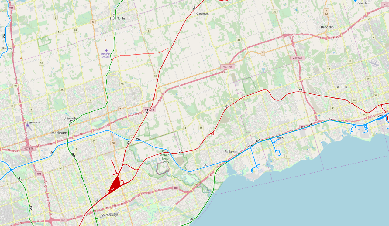

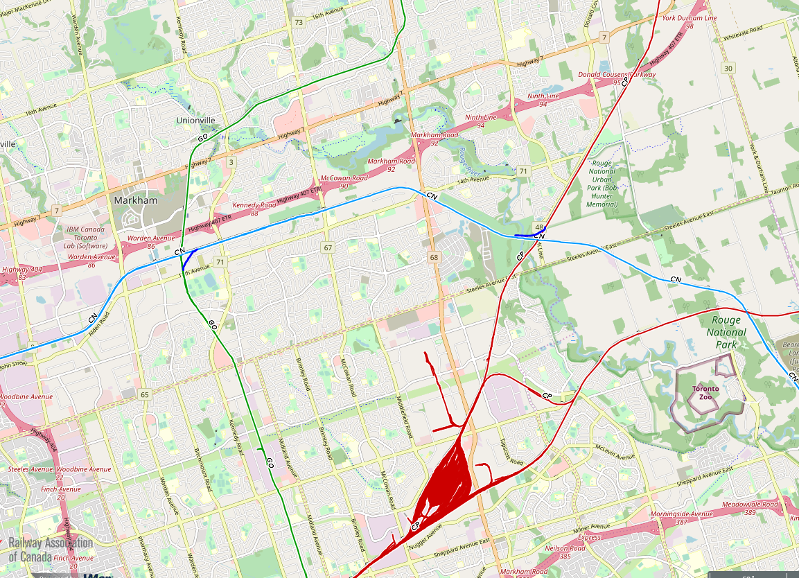

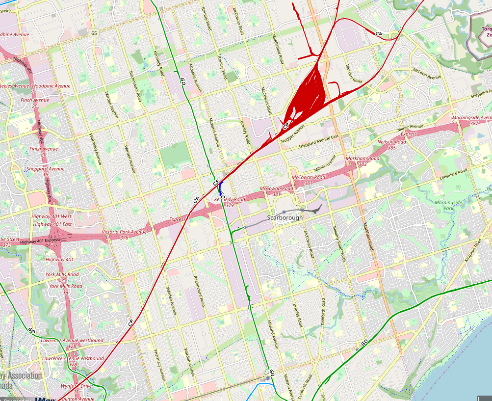

I feel like the brickworks bridge and Don Branch could be avoided if either a spur line was created from the CP Havlock Line to the Stouffville Line
194399
OR, use the CN York Line to connect to it
194400
This would avoid needing and work done on the Don Branch/Bridge, as well as avoiding the CP yard and mainline.
You could also cross at where the CP mainline intersects with Stouffville, but this is less advantageous as you still deal with the CP Yard and mainline
194401
Would have to contend with frequencies on the Stouffville Line, but typically Metrolinx and VIA get along better than Freight lines and VIA.
All interesting ideas and thanks for including maps. I just think that GO may be very cautious on giving up track capacity to the HFR service. Also, I think CN would want rail grade separation (just like CP probably wants) to get the HFR service from the south side to the north side.
