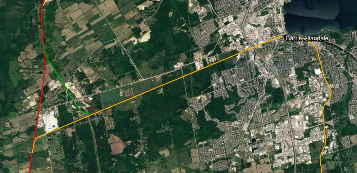

The use of GO Barrie is intriguing but I doubt proposed AD2W service would accommodate it. Also, much money would have to be spent upgrading the BCR to Utopia including a w/b to n/b connector track, and I'm not convinced there is space there.
There is indeed space at Utopia Junction for that connector track, because there is the abandoned rail ROW of the former North Simcoe Railway (the Northern Railway branch line between Barrie and Penetanguishene):
Red line is CPR
Amber line is the active portion of Barrie-Collingwood Railway
Green line would be new tracks on existing abandoned ROW
Providing this connector would save quite a lot of time for the northbound trip out of Toronto as it would avoid the need to do the three-point-turn to go from northbound Newmarket Sub to easbound York Sub at Snider Diamond.
That said, one advantage of the current routing is that both directions of the service pass by Langstaff / Richmond Hill Centre station, which has the potential to become a convenient suburban GTA access point for the train. And there is space to extend the platform north, in fact doing so brings the train closer to the overpass to the RHC bus terminal.

I forgot about that stub; my mind was focused on the land right around the diamond. It is now severed with the recent reconstruction of CR 90 and many pennies would have to be spent building a grade separation (assuming one was desired) not to mention the problems caused by an undulating highway profile created by two overpasses in close proximity.

I must be missing something here, but are you proposing northbound Barrie-Utopia-MacTier to Parry Sound? But not southbound (to avoid the wyeing issue)? If that's the case (which also bypasses Washago northbound), why not just use CP MacTier all the way to Parry Sound since a unidirectional link to Barrie isn't much use to anyone?
