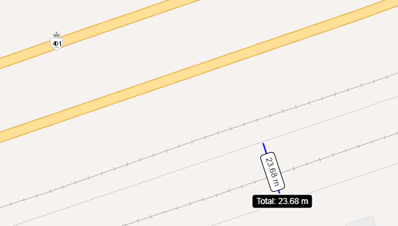

You should be able to get an approximate indication of the widths, if you look at the (approximate) property ownership lines on county-(region-)-level or municipal-level mapping in Ontario.
Let's look at Whibty for an example. Their mapping tool is http://explorecommunity.whitby.ca/OnPointWebsite/WebPages/Map/FundyViewer.aspx You can see from the property lines over the air photo, that the CN track is in the middle to south of their alignment. Most of the space between the CN track and the GO track is owned by CN. Sadly, there doesn't seem to be a measurement tool on the Whitby site.
The Region of Durham map tool is at https://geoapps.durham.ca/Viewer/index.html?viewer=YourDurham.YourDurham and includes a measurement tool - but no air photos that I can see. But easy to measure, and the row comes in at about 23.7 metres wide here I get over 24 metres elsewhere.. About 80 feet wide.
There's certainly not any space south of the existing GO tracks on MTO land for any further tracks.

Excellent find.
The ownership template shows the land between the GO sub and the 401 as belonging to the MTO with a mostly variable ROW of 32m-50m though there are choke points.
While much of the land between the CN tracks and the GO sub is CN's, this too varies. The ownership template shows, for instance that the land between the GO Whitby Station and the CN tracks belongs to GO/MTO.
The place I had seen a lot of this real estate ownership structure was from an EA process initiated some time ago for widening the 401 from Salem Rd, to Courtice.
I can't seem to find any of that material online anymore, but it showed the land the MTO was contemplating using for said expansion, and much of it was the land between the existing 401 and the GO sub.
The expansion took various amounts from some to all of said land depending on the section.
Suffice to say, there is sufficient land north of the existing tracks (for this section) for the most part, with some challenges were CN uncooperative.

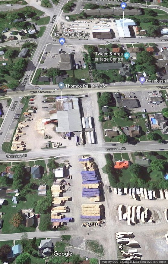

One poster writes:
"Take a look at downtown Tweed for instance".
OK, let's:
https://www.google.ca/maps/place/Tw...f249c7fca1ec9189!8m2!3d44.474728!4d-77.310249
The Trail continues right through town. Not one building on the RoW. Companies might be using it while the Township/County looks the other way, might even be leasing, but doubtful, but they certainly don't own it. And can't build on it. The Ontario Trails Act would prevent that even if they did own it, which they don't.
I've researched it all years back in this very string. Once again: Show reference to your claim!

Railroad property widths are the same standard width of public roads in Ontario - 66ft (20.12m). So it's safe to assume that most rights of way are this width for single or double tracks in most areas of the province.
Within the GTA of course, that could be different as those widths are gradually widened.
