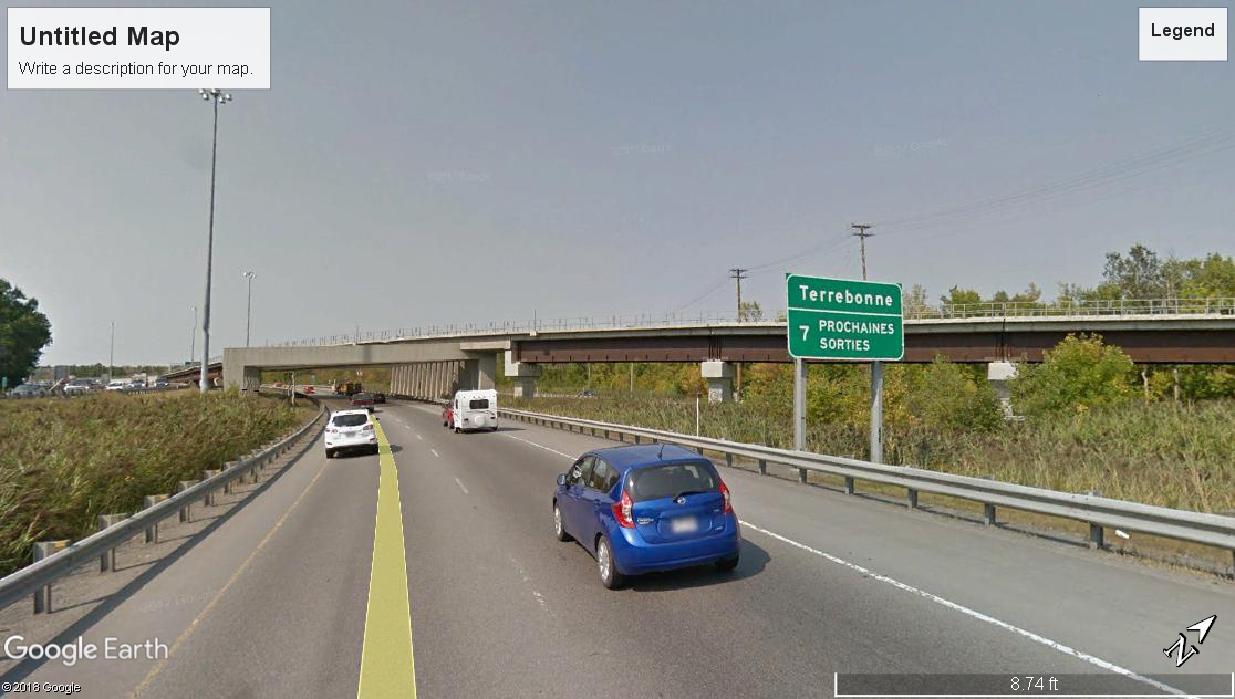

The problem is less building a railway within the Highway median per se than having to enter and to leave the median at some point: the smaller the angle is in which you intersect with the Highway lanes, the more expensive the grade separation will become - and starting from the median means that you start from a position only a few meters away and parallel from these Highway lanes. I just have to drive 20 km north from Montreal to see the almost 500 Meter long bridge which was required for the Train de l'Est to enter the Highway median near Repegtigny:
It should also be noted that leaving the Highway median is not only required at the start and end of the whole bypass, but also whenever the highway makes a significant bend (unless, of course, you are fine with having the train slow down for the Highway's design speed, i.e. 120-140 km/h). The problem with "side-running" is that you would either have to go underground at every current (and future!) Highway exit, in order to allow the Highway access ramps to pass over the tracks, or to have so much distance between the Highway and the new ROW that you loose most of the benefits of bundling both. Also, you might have to realign the entire Highway if you are on its outside in a curve and require a much higher curve radius than what the Highway has been designed for...

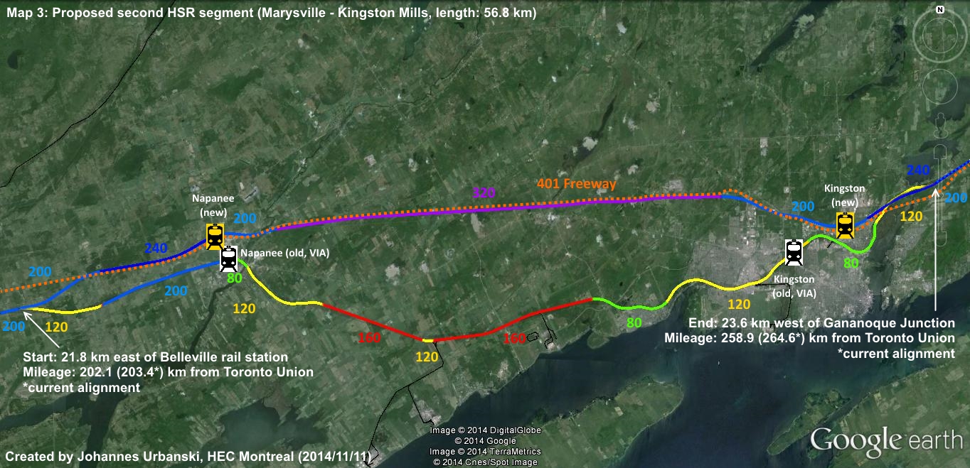

I've already proposed something very similar to your idea here 4 years ago:
The first HSR segment would be approximately 38 km long, leaving the CN alignment directly after Oshawa and rejoining just before Port Hope after following (and crossing two times) the 401 Freeway:
The second HSR segment would leave the CN alignment in Marysville and rejoin it approximately 57 km later in Kingston Mills after bypassing Napanee and Kingston, thus necessitating the construction of new rail stations on the northern side of the 401 Freeway:
However, having read up on this subject since then, I have started to understand that the viability of any intercity greenfield rail project comes mainly from increasing available rail corridor capacity (which actually was the main motivation for building HSR in Japan, France, Germany and Italy, while decreasing travel time was just a welcome side effect). You therefore need to bypass the pinch points which constrain capacity and I'm afraid that those pinch points which constrain the current frequencies between Toronto and Ottawa or Montreal are not located between Oshawa and Port Hope or Marysville and Gananoque. You would therefore be stuck with exactly the same frequencies as today and almost the same delays and while you may indeed end up saving 20-30 minutes from the existing travel times, I'm highly sceptical that these travel time savings alone would represent sufficient benefits to justify the non-trivial construction costs...

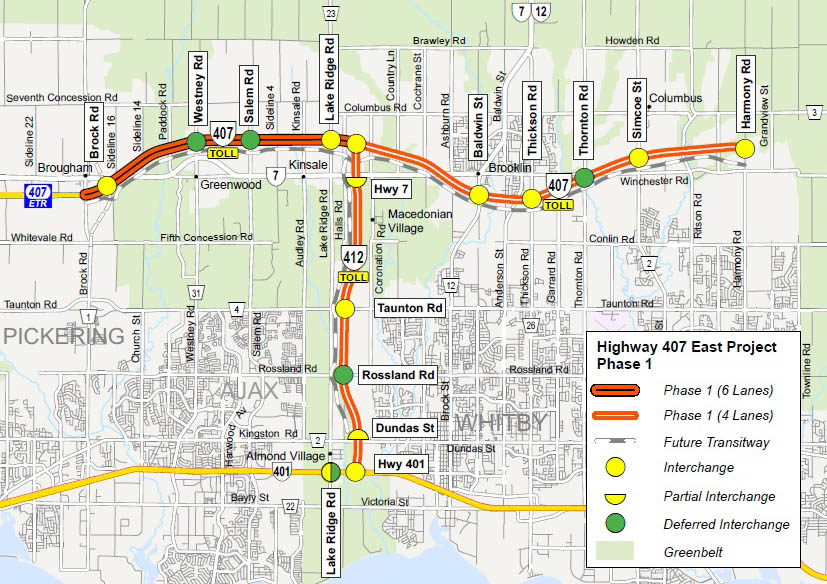

PS: Are we by any chance talking about a different Highway 412 when you remark that "The 412 as noted is quite straight"? This Highway 412 segment at least looks neither straight nor conveniently located to double as a rail corridor:
http://www.thekingshighway.ca/MAPS/Hwy412map.htm

I expressed myself poorly, in as much as I'm not stuck on the median notion as the use of an ROW already in public ownership.
You can see the 412 ROW on google and its rather larger than the existing highway and offers a straight-line up for a railway, the track might be at times, but need not be confined to the immediate alignment of the highway.
I'm curious about that bend in 412, at first blush it doesn't appear necessary, I'll have to look up the EA as to why they did it that way.
