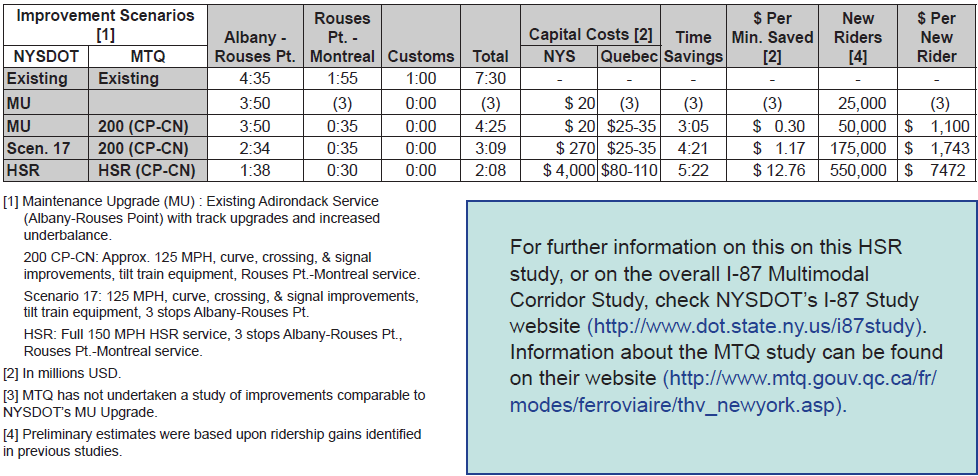

In case you want an illustration of the exponential costs and diminishing returns increasing rail design speeds yields:
Source: New York State DOT and Transport Québec (2004, p.4)
Key quote from the same study (p.1):
NYSDOT and MTQ said:
HSR in the Corridor Has Merit. The NYSDOT and MTQ pre-feasibility studies indicate that the development of HSR in this corridor has merit. However, given Full HSR’s multi-billion dollar cost and lengthy (10+ year) implementation time, and the corridor’s environmentally sensitive Adirondack Park location, rail passengers would be better served by incremental improvements implemented in stages. Concurrently, New York State should investigate FRA requirements for the corridor to be designated as part of the US HSR network. This would provide a basis for both MTQ and NYSDOT to develop justifi cation for future federal funding for HSR.
