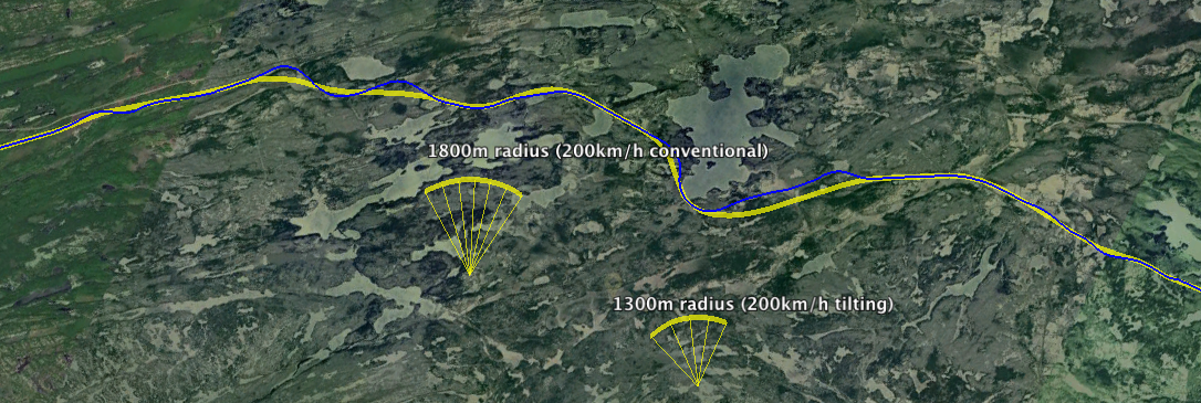

Using Google Earth, I've been trying to conceptualize how the Havelock sub would need to be realigned to support the continuous 110mph (177 km/h) speed limit required to achieve VIA's 160km/h average speed claim. First I drew 1300m and 1800m curves on the ground, which are the minimum radii at 200km/h for tilting, and non-tilting trains respectively, according to that chart on Wikipedia. Then I tried to free-hand an alignment that keeps the curve radii above 1300m (tilting trains @ 200km/h).
In the image below, the current ROW is in blue, and my free-hand realignment is in yellow. This segment of the line is so curvy that when the minimum curve radius is increased, almost none of the original ROW can be reused. The current ROW has one beautifully wide curve on the right side of the image that can be reused, but then to the east the line gets very squiggly and would need to be bypassed again.

According to this, a superelevated curve with a 450 m radius can support tilting trains going 120 km/h. So if the Havelock sub indeed has 600 m curves and Via buys modern tilting trains, speeds would be faster than that. BTW where did you get the information about the Havelock sub curves?

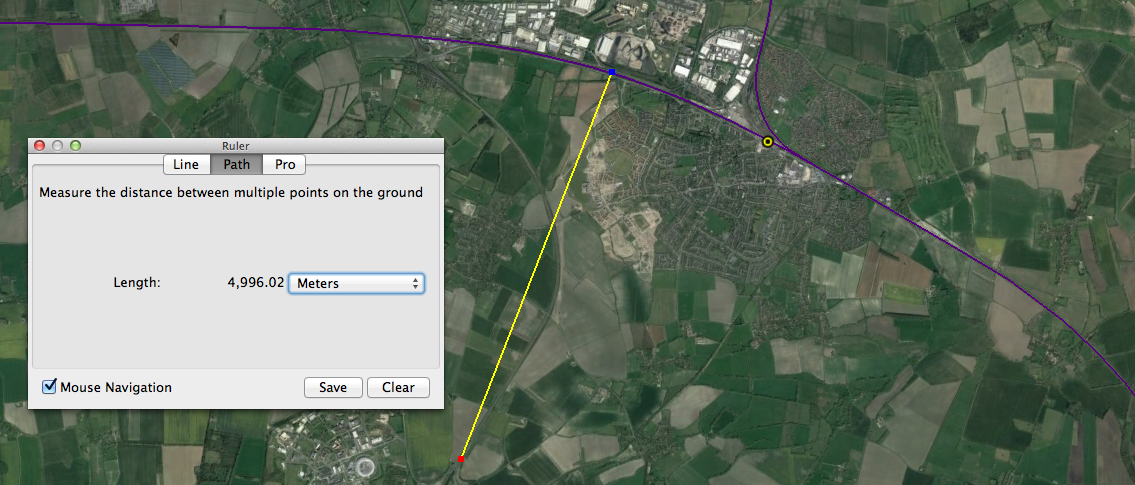

The Western Mainline in Britain was mentioned a while ago as having an abundance of sharp curves and speeds in the 200 km/h range made possible by tilting trains. Does anyone know the curve radius on that line?
I roughly measured the radius on Google Earth similarly to how I drew the radii in the image above, by trying to find the point equidistant to all points along the curve.
When they say the West Coast Mainline is curvy, it's relative. The East Coast Mainline and Great Western Mainline have enormous curve radii, on par with some modern high-speed-rail lines. The curve below on the Great Western Mainline just outside Didcot (randomly selected, they all seem similar in that segment) appears to have a radius of about 5000 metres.
When they say the West Coast Mainline is curvy, it's relative. The East Coast Mainline and Great Western Mainline have enormous curve radii, on par with some modern 200-250km/h high-speed-rail lines. The curve below on the Great Western Mainline just outside Didcot (randomly selected, they all seem similar in that segment) appears to have a radius of about 5000 metres.
This is what I've been trying to point out here for a year - but have been too lazy to map it myself. The alignment is completely unsuitable.
Now you've come up with something that might work. But remember the reason it was so curvy in the first place was elevation issue. So you'd both have to pretty much build a new alignment near the old one, and do a lot of blasting, cuts, and huge fills. And that's not happening for the $ amounts we've seen proposed.
Yes, I forgot to mention this. The map is purely an illustration of how much change would be required in the ROW to widen the curves. I happily blasted the line through hills and across marshes, basically the only obstacle I didn't ignore was large lakes. Not really feasible within the shoestring budget they've been showing.
