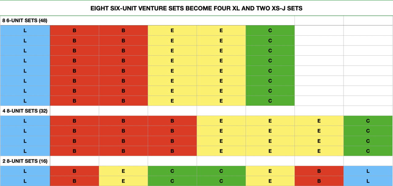

VIA's plan to reconfigure its Venture sets. Two XL sets and one SX-J set are already complete. (L=locomotive, B=Business, E=Economy, C=cab car.

Presumably there's a technical reason in the L-B-E-C-C-E-B-L set not to do L-C-B-E-E-B-C-L or something, to not put the cab cars in the middle?

The B car has a coupler on one side which needs to be joined to the locomotive, but is probably not like the external loco and cab couplers

Thanks, nice to see it visualized like this!
If/when the shunt enhancers get installed, I wonder if we'd ever see LBEC sets running on a segment like Sarnia-Toronto? I remember as a kid when it was serviced by just two or three Budd cars. (That was my first train ride ever, and I felt cheated that it wasn't a real train. I know rail fans love them, but they felt old and dingy to me even back then in 1980 or 81.)

I've summarized the specs for these three configurations:
The total number of seats is roughly the same but the distribution is very different - the 7-car sets have a much higher percentage of Business seats. That would make them better suited for runs such as Toronto-Montreal with lots of business travel. Milk-run services serving the smaller cities and towns along the routes would presumably have a higher percentage of Economy class demand and would be better served by the 2x 3-car sets.
The 7-car sets have barely half the power-to-weight ratio of the 2x 3-car short sets, so they would be best used on services with minimal stops, such as Toronto-Montreal. Services with frequent stops are better served by the 2x 3-car sets.
Hopefully there's a solution to the train cycling puzzle that puts the 7-car sets on express services as much as possible, while the 2x 3-car sets get put on local services as much as possible.
The elephant in the room with combining coaches into longer trains is that some departures will need to be cancelled due to the reduction in total trainsets. The trains that remain will also need to make more stops, to maintain service at intermediate stations despite the cancelled trains.
