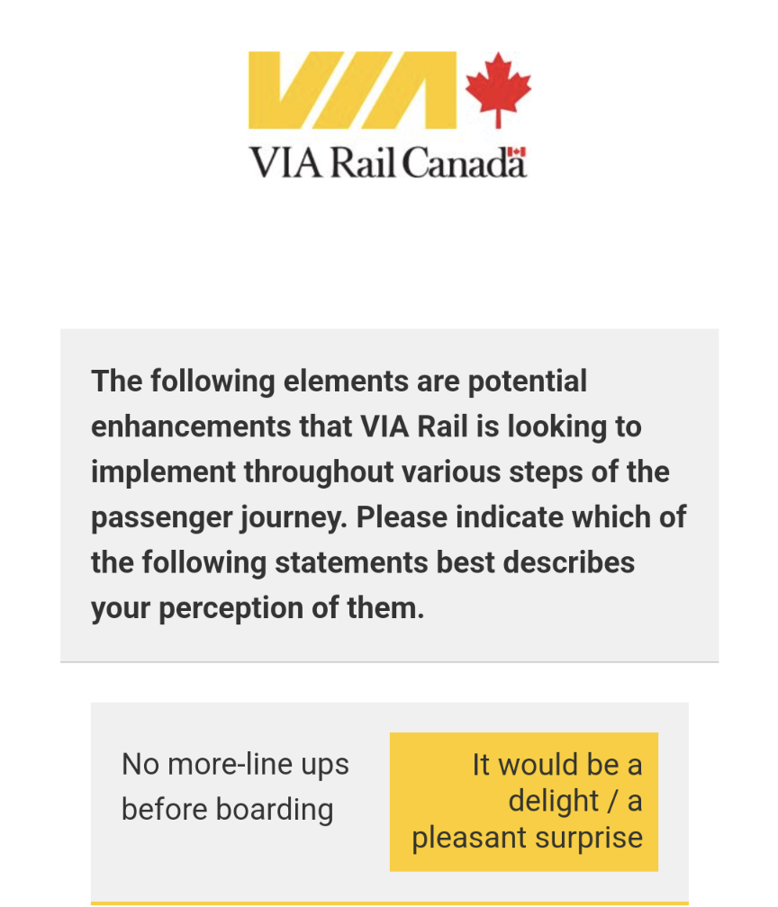

Completed a very long VIA survey today, including this question:
