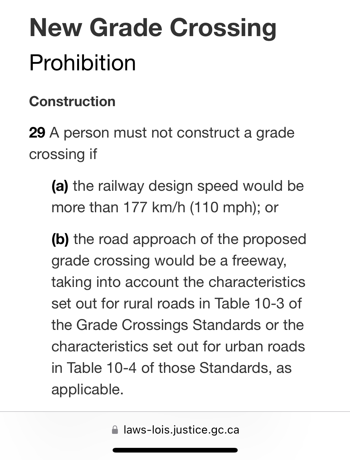

Canada’s Grade Crossing Regulations forbid the construction of at-grade crossings for speeds in excess of 177 km/h (110 mph) or with Freeways:
If you might elaborate on the bolded, it would be appreciated.
What improvements are in the offing? and What impact will those have?

Wow, they really aimed low with that law. In Canada this law would never apply. Next up, trains must give way to Starships.
I’m not sure what exactly you are trying to say, but in Germany (and most countries I’m aware of), this limit is at 160 km/h.
What I am saying is that the goal of such a law is to reduce risk of deadly collisions. The law could have been that new roads crossing railways with passengers whipping by at 140km/h shouldn't be allowed and really pushed the provinces and municipalities to create more grade separations and improve safety. How many roads have been proposed in Canada to have a level crossing on a railway line with 177km/h train speeds? Where are these railway segments that this law applies to? How has this law improved safety in Canada?
You are right, it’s indeed the only piece of Canadian rail regulations I’ve seen so far which acknowledges that anything beyond 100 mph (160 km/h) exists. However, I believe that section (b) in that rule refers to a formula (something like cars per day times design speed) which determines when road crossings must be grade-seperated (i.e. the busier said road, the lower the permittable speed limit)…
If I understand this, that means we could see good incremental changes on the line to get the speed up to to this limit. To be fair, 177 km./hr pr100mph isn't nothing to sneeze at when existing trains along the Corridor can do 90mph. Full grade separation could be done piecemeal such that once thy are ready to spend the bigger money for converting it to HSR, the crossings won;t be the problem.
For what it’s worth, the 110 mph limit matches the FRA limit for level crossings, which suggests that they simply copied it over from their American counterparts and would explain how they set it at a speed for which not even track classes have been defined…
At least they didn’t copy over the exception for 111-125 mph, if any railroad would bother to put up with errecting „impenetrable barriers“:
Canada’s grade separation assessment guidelines can be found here. They were created in 2018 in response to the VIA Rail/OC Transpo bus collision.in 2013. I gather that before these were created, Canada didn’t have any official guidelines for where grade separations should be located and studies would borrow guidelines from other countries.
EDIT: digging a bit deeper, these guidelines seem rather conservative. For example, they say the one of the thresholds for grade separation. is a cross product of 1 million, but a study done in 2017 about several crossings in Ottawa says the threshold should be 200,000. My guess is that Transport Canada knows that hundreds, if not thousands, of level crossings, would need to be grade separated if they set the bar too high.
