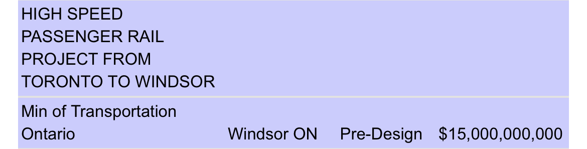

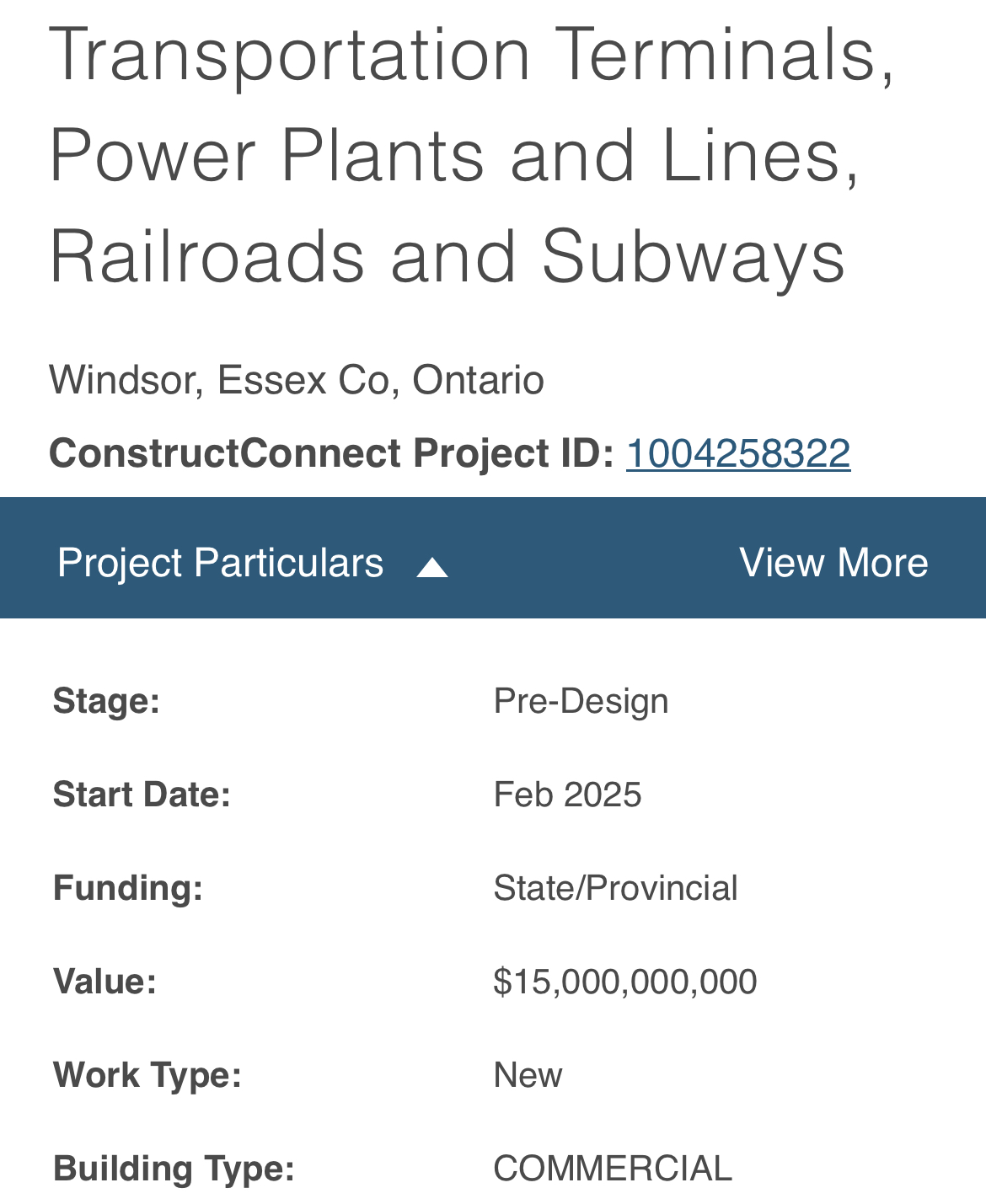

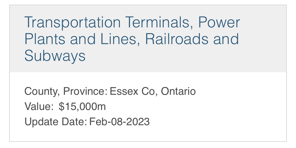

Not sure if this is the right thread, but…
Does anyone know why the hell there is an entry in ConstructConnect from MTO for a $15B pre-design bid for a Windsor-Toronto HSR project? It was last updated in February 2023. The dollar value does not align with the original 2017 HSR proposal, which was estimated to be $21B.
