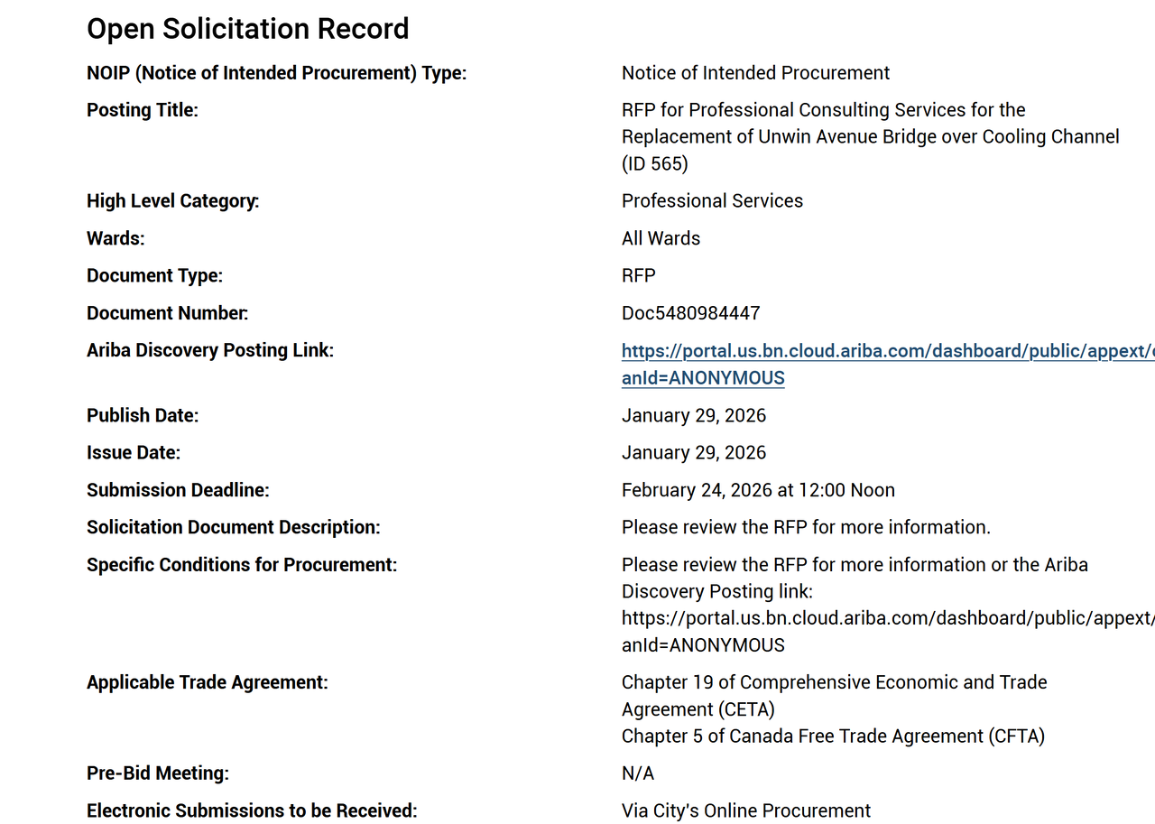

Of course the City knows the condition of Unwin, I think the reason why it has not been 'touched up" with a Grind & Pave is that they know it needs proper storm drainage plus the watermain is either old and small or there actually isn't one at all. It really makes no sense to do more than the smallest amount of 'repair' before the bridge is replaced and the water/drainage dealt with. They also need to get the rail spur rails removed. Of course, the section of the street east of the bridge is NOT a City Road - it is a 'private road' and belongs to the Toronto Portlands Co (which is part of CreateTO). (That is why that section, between the bridge and the driveway to the Portlands Energy Centre has no streetlights.)
