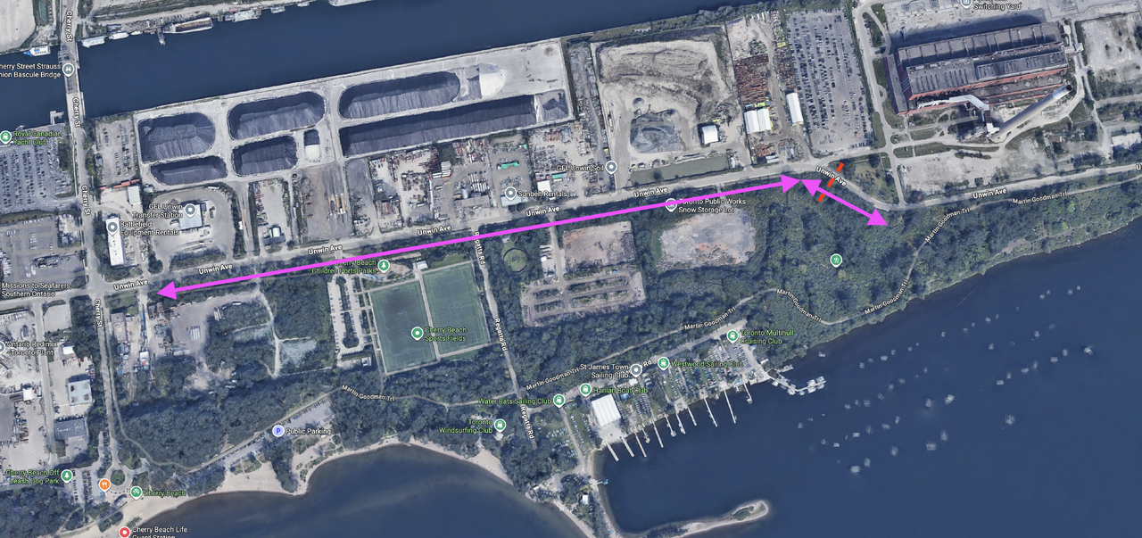

Unwin Ave - Undriveable
Called 311 yesterday to report that all of Unwin Ave from Cherry east to the Hearn is basically undriveable.
Huge, enormous potholes so big they would swallow your entire wheel right up to the axle all over the place. You have to constantly swerved back and for forth across the entire road to avoid them.
I suppose a dump truck or cement truck could hit them and survive, but anything smaller would rip their wheel right off.
And if the pot holes don't catch you then the tracks at the end (in red dashes) are not longer in the road, they now sit a full 5 or 6 inches above what used to be the road making it like as if you just drove straight at a set of railway tracks.
It's totally and completely nuts.
The nice lady on 311 couldn't help with anything and just kept saying, "I'm just trying to find which intersection you're talking about..." And i was like, "No ALLLLLLL of Unwin is f*cked!" :D
