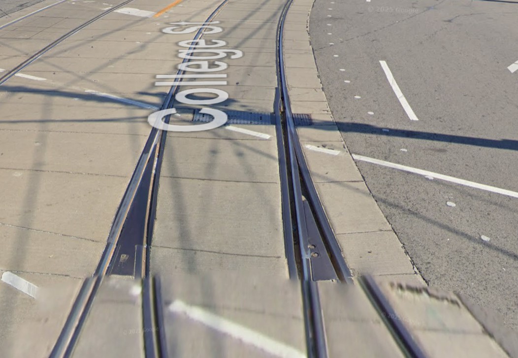

Can someone post a picture of a dual blade switch? I was trying to visually understand the difference and google images isn't helping.
Pretty much any photo of a tram switch outside of Toronto will be a dual-blade switch. Here's one from Wikipedia - note how both of the rails move when the switch changes direction, as opposed to the Toronto design where only one of the rails moves.
The 2018 image shows a single-point switch:
So their 'test installation of a dual leaf switch' doesn't have dual leaves?
That's correct - it has the geometry similar to a double-point switch, so you can see how much longer it is.
In fact, as I recall due to its design this switch is not trailable anymore - any car that is forced to reverse through it is only allowed to do so a on the straight.

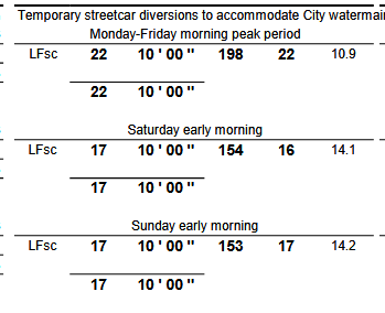

The current service summaries are a problem in this calculation, on this route, for the simple reason of the diversions ongoing.
That said, its worth comparing what the TTC says, to the math above:
The above is the January Service Summary for the 501.
Column explanation:
From left, number of streetcars scheduled, frequency/headway, RTT (Return Trip Time, so both ways, in minutes), then average speed.
So quite handy there, we have the impact of getting to 14km/ph just by looking at the weekend schedules.
These times obviously differ slightly from the math I gave.
Let me translate them though. 198m round trip is 3hr 18m, which is 99m or 1hr 39m one-way.
Using the Saturday numbers, 154m round trip is 2hr 34m, which is 77m or 1hr 17m one-way.
Ok..... fun facts over..... LOL
