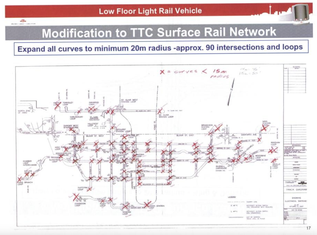

Somewhere I saw a TTC diagram highlighting the locations of the tightest curves but I can't find it right now. If anyone else knows where it is, that would be much appreciated.
Steve Munro has an old blog post from 2008 with this diagram from a TTC presentation.
Thanks! Turns out it was a 20-metre radius they were looking at, not 25, but that's still obviously silly. They show that they can't increase the radius from 15 metres to 20 at King & Dufferin, but that misses the point that 15 metres is already far better than the 11-metre radius found in a handful of other places on the network. The question isn't whether we can increase the radius at King & Dufferin, it's whether we can bring other corners up to the radius we already have at King & Dufferin. Steve mentions in the comments that Basel has a minimum radius of 11.8 metres, Boston has a minimum of 13.5 m and Melbourne has a minimum of 15 m. Getting up to those slightly higher radii would presumably make it possible to use those cities' tram models with relatively little modification.
In the same presentation they show this diagram, which suggests that there it might take as few as 5 curve realignments to get the minimum radius up to 12.2 metres, or 8 realigments to get it up to Boston's 13.5 metres.
The purpose of that discussion in 2008 was related to an imminent vehicle procurement so yes of course the conclusion was that they couldn't rebuilt the network to make off-the-shelf streetcars fit. But after making that conclusion there was no plan set forth to address the infrastucture issues over the next half century for the next time we need to procure streetcars.
I also can't help but notice that the vast majority of the sub-15 curves crossed out on the map are short-turn or terminal loops that would be unnecessary with bidirectional streetcars...
