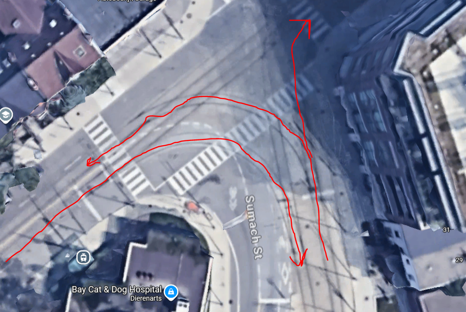

White bar in Toronto means "turn left or right but do not go straight". For example, at King & Sumach, the eastbound and northbound white bar signals come on simultaneously, allowing eastbound right and northbound left/right turning streetcars to proceed simultaneously.
The HTA also technically allows streetcars to proceed straight during a vertical white bar but the TTC chose not to adopt that definition so they could use more efficient signal operations like the one above. If they used the HTA definition, the northbound and eastbound streetcars couldn't get white bars at the same time.
Your photo is basically just a left turn phase for a streetcar. The red/yellow/green signals represent the straight movement (i.e. permissive left/right turn), and the white bar represents the protected left turn.This exact same signal layout is used in lots of other locations as well, such as King & Sumach as mentioned above. It's no more of a Frankenstein signal than the signals for cars that also have red/yellow/green for going straight, but then also a separate left turn arrow that's controlled by a different signal phase.
