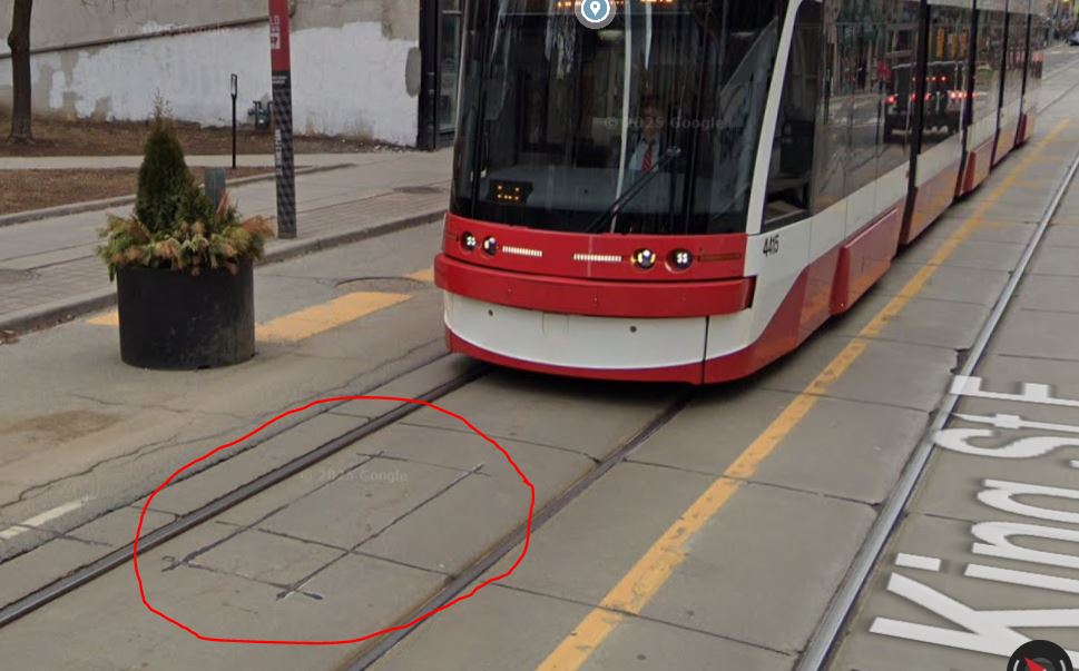

Based on streetview, the TSP request detector seems to be just past the stop at Jarvis, so as long as it left the stop before the start of the countdown, TSP will hold the light in Green/Walk until the streetcar reaches the Church St (up to a maximum of 30 seconds).
However, TSP is disabled for streetcars that are less than 90 seconds behind the previous streetcar, to minimize bunching.
If you know it was at least 90 seconds behind the previous streetcar and you saw the streetcar cross the detector before the ped countdown started and yet the ped countdown still started while the streetcar was approaching, then something is broken with the TSP system. Or maybe the operator stopped too far forward and hit the detector before serving the stop. In that case they will miss the green because it will max out the extension before they reach the intersection.
If the signal briefly showed Green/Don't Walk that may have been due to a routine signal timing adjustment rather than the priority system. I doubt they would use Green/Don't Walk extensions at Church given the low speeds.

They have two detectors. A "check in" detector (that's the one just past Jarvis that I showed) and a "check-out" detector just past the stop line. Sometimes there are also intermediate detectors to update the streetcar's ETA as it approaches (e.g. WB St Clair & Gunns). The streetcars have radio transponders on the bottom at the front and back that send signals picked up by the detectors. It's the same transponders they use to change track switches. I show it in practice in my TSP intro video:
