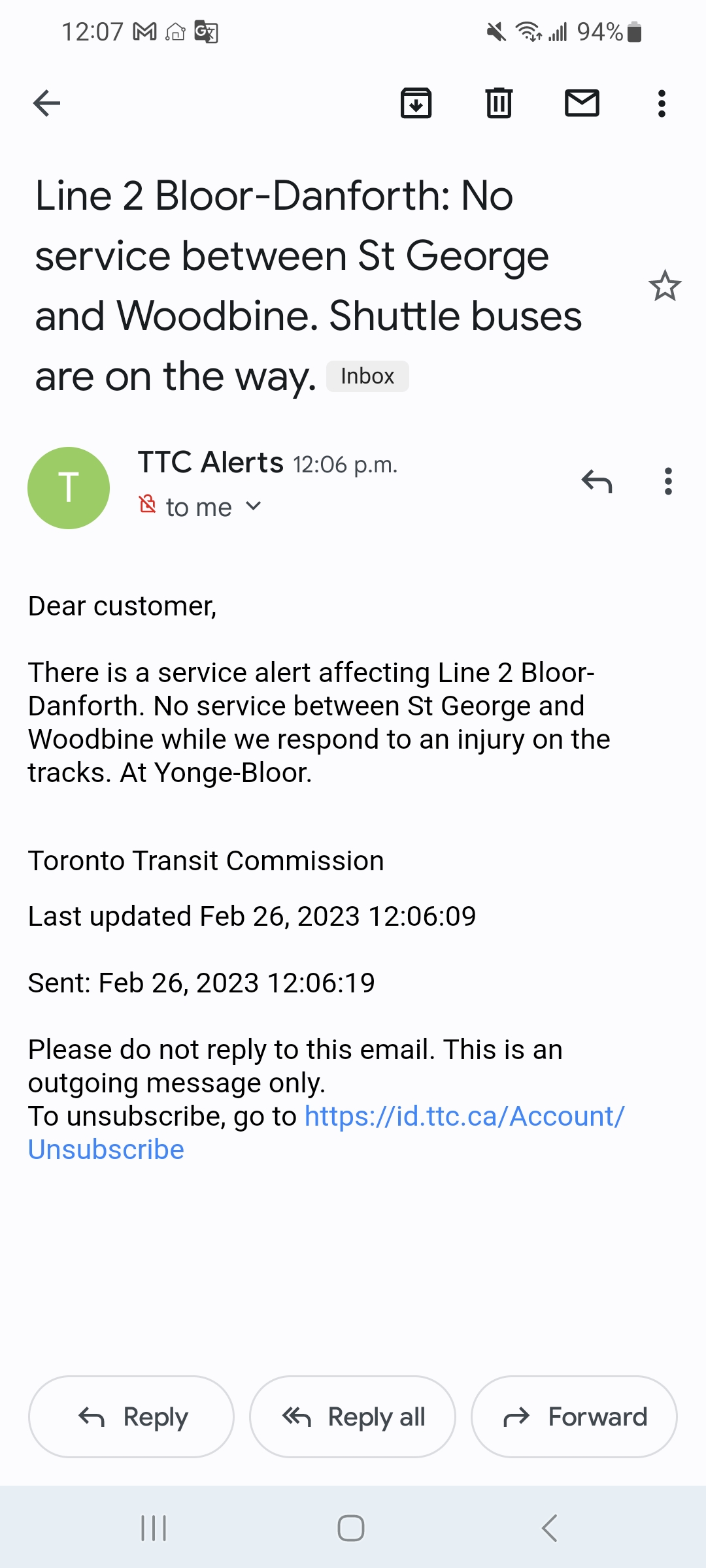

Is there a reason trains have not turned back at Broadview or Chester during the last two "personal injuries"?
Both times it has been St George to Woodbine despite the incidents occurring well clear of Broadview or Woodbine.

I don't think they'd ever turn back trains at Chester, for the reason that there's no surface infrastructure there to take on that passenger load.
Broadview is also kind of awkward, because the pocket track is much closer to Chester. I also think there's some kind of limitation in that interlocking that prevents moves from WB chester to EB broadview, so trains can only use the WB platform at Broadview to turn back east. This creates big delays because one train at a time must proceed into Broadview, then wrong-way back into the pocket track at restricted speed, then back onto the EB mainline. The next train has to wait at Chester the whole time. Despite it physically being possible, Broadview's not really set up to be a terminal -- the move reverse into the pocket track is a call-on signal vs. a normal yellow/yellow, and the operators have to stop and push a lever at the signal to proceed -- more delay. There also isn't an exit signal reverse at Broadview WB like at other crossovers.
At Woodbine, trains can empty, crossover past the station, and turn around very quickly. It was designed from the outset to be a terminal.

Trains have gotten turned back at Chester all the time. But they don't get offloaded there. They would generally offload at Pape, where there's a proper bus facility (plus lots of routes with which people can take, rather than just the shuttle.
They have turned trains back at Broadview in the past, but as you note that involves a much longer stretch of single track and the trip-arms tied down, so headways get affected much more negatively.
But what has changed in the past year or two is that the crossovers into the Chester Pocket track have been changed to "jump frogs" from the traditional style. While this means that trains on the mainline can now go through at higher speeds and with less vibration/noise/wheel impact, trains entering and exiting the pocket have to do so at a much lower speed. I wonder if for some reason the TTC has gotten cold feet about its use.
