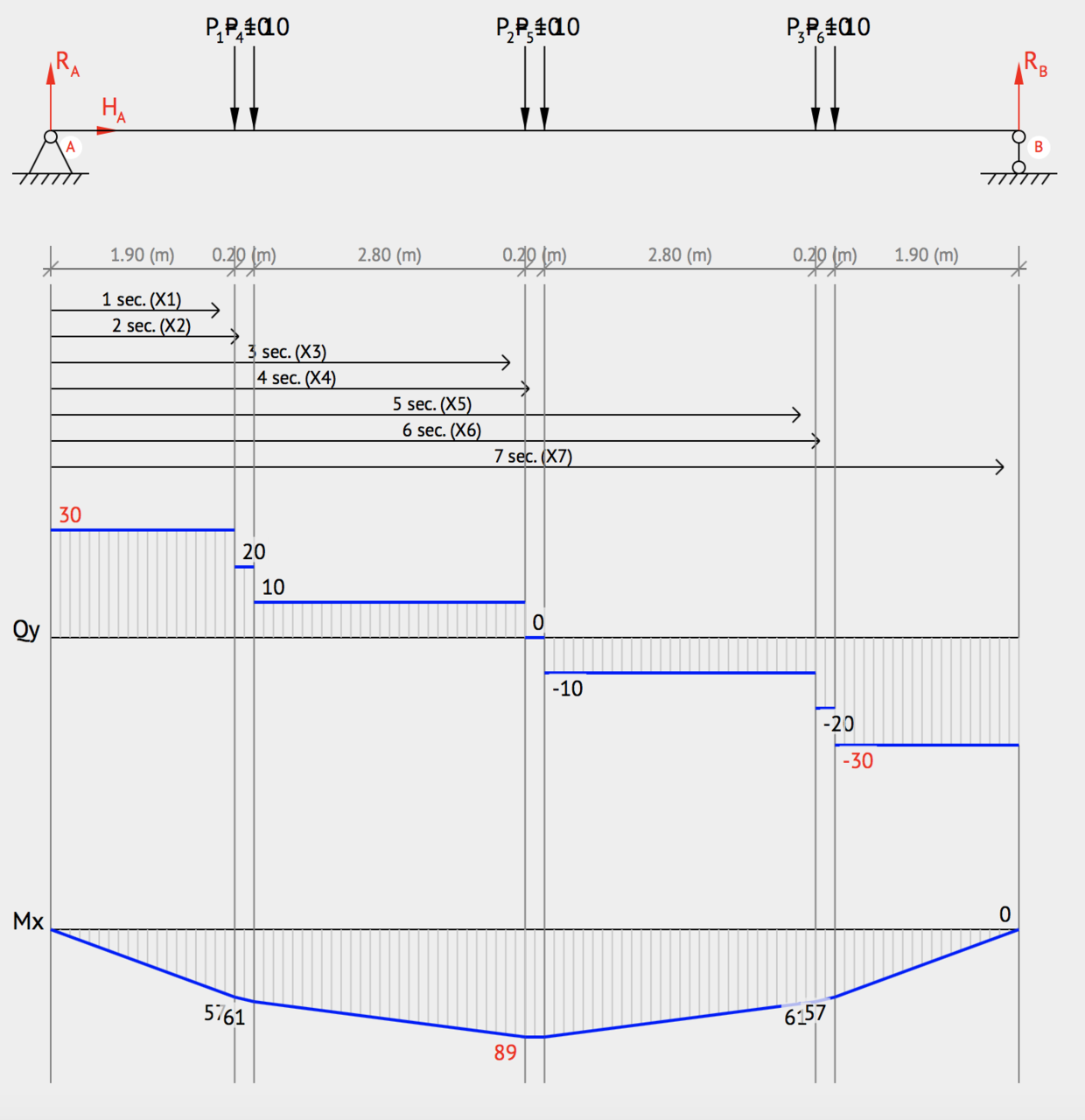

I'm not quite sure I fully believe it either, given a 30-metre Flexity weights about 48 tonnes - about 8 tonnes per axle compared to a 12-metre bus which weighs 19 tonnes, or 9.5 tonnes per axle.

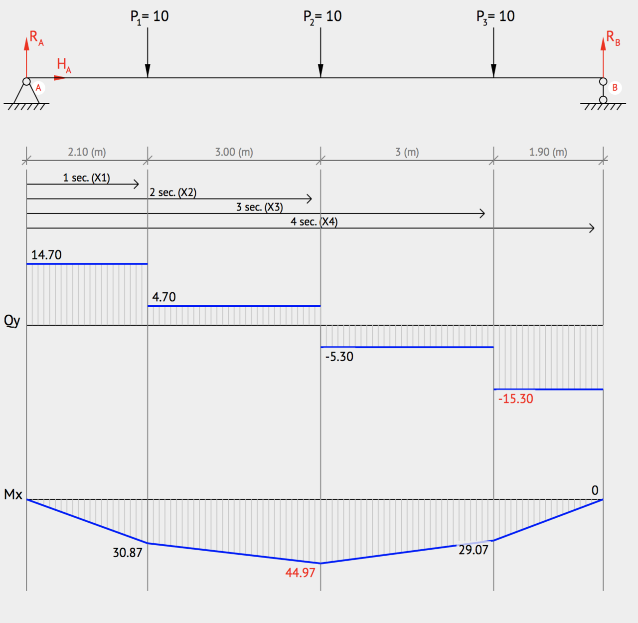

This may be the loading for the streetcar, notice how the moment can increase to 89 kN*m, compare this to an articulated bus:
193618
Which would see a bending moment about half that of a streetcar.
Let me just clarify, this is not at all how the structural mechanics of the actual station would behave, but the point is to show the significance of bending moments. Even just the increased shear stress could force the concrete to break.
The major takeaway from this is that you have to be careful with not just the force the wheel exerts on the ground, but the location with respect to the beam supports. Streetcars have very closely spaced wheels, so having two sets close together will ultimately impact the loading of the plate it is on. You can pretty much treat it like a point load with double the mass.

Which would see a bending moment about half that of a streetcar ...
An 18-metre bus has about half the bending moment than a 30-metre streetcar.

But the point was that the placement of the wheels on a bogie of a tram will affect the bending moments induced on the plate. Since a tram's bogie has 2 axles close together, the force will effectively still be double that of a bus. Vehicle length doesn't really matter when all loading occurs in distinct areas.

In other words, the bus may be applying 9.5 tons*g of force per axle, but because those axles are almost always evenly spaced, the strain (and therefore bending moment) induced on a plate will be pretty much always evenly distributed.
The design of the structure is obviously not one giant plate 10 meters long simply supported by 2 beams at each end, that's pretty much begging for a structural collapse. Therefore, even though the 3 buses and the one streetcar weigh about the same and have about the same length, the difference is in the placement of the axles. Since Streetcar bogies have 2 axles very close to each other, the effective load is much greater than the evenly spaced bus axles.
