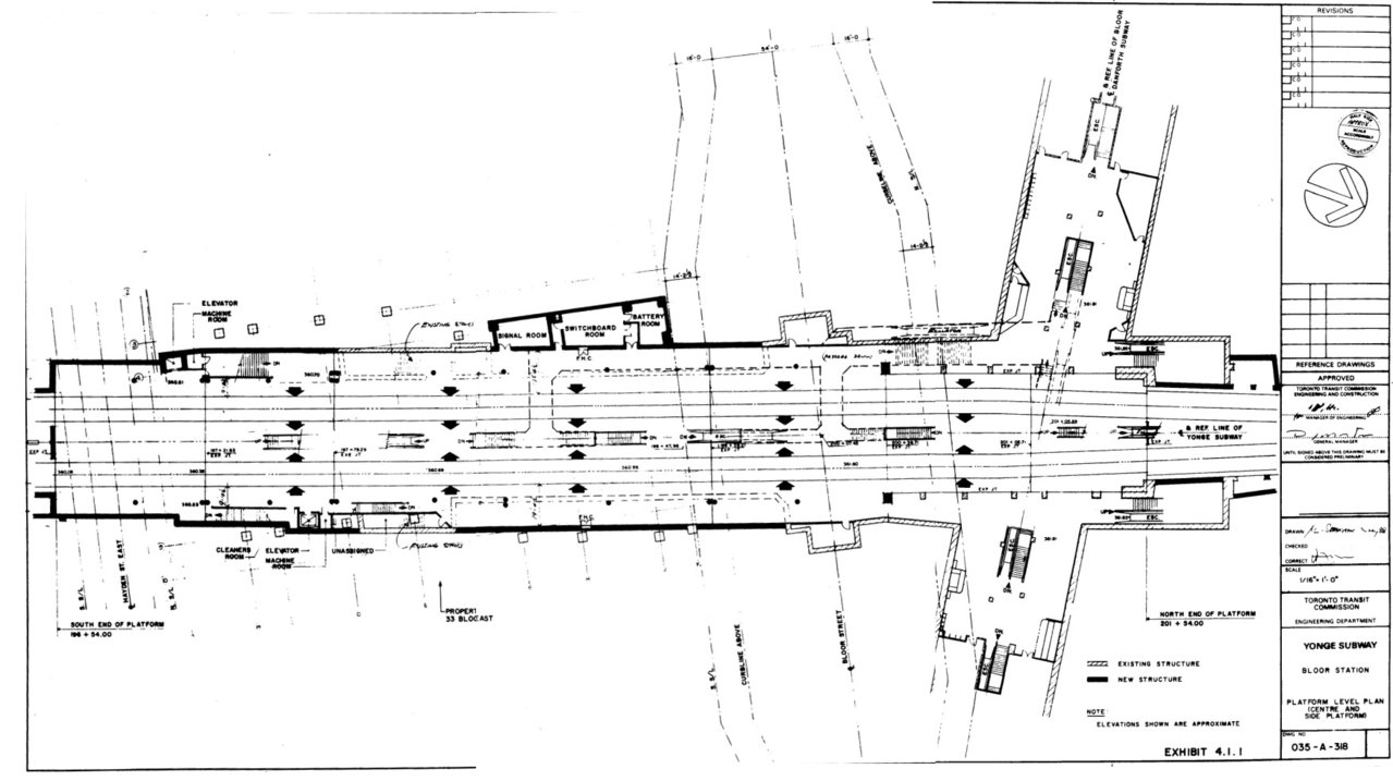

For reference, the 1988 Y+B Platform Expansion proposal - merged from plans posted by Steve Munro:
https://stevemunro.ca/2008/11/02/yonge-subway-headway-study-1988-part-5/
And plus how long can you close down Bloor Station to Spanishize it. Unless they can do all the work over a long weekend.
I seem to recall that the plan in the image would’ve required Bloor to shut down for a substantial amount of time.
Since they like deep tunneling these days including in sparsely populated areas they could build a completely new Bloor platform underneath the Yonge platform perhaps part of a second Yonge Line.

The problem with that Bloor-Yonge masterplan is it doesn't solve the part that everyone will be piling up at the near the northern side of the platform and would have to walk down. If they are going to rebuild it, the should shift the platform north like they are shifting Eglinton.

Yonge Station could get Unionized by adding a new south platform for eastbound trains which would push half the transferees down the Bloor platform to start off with.
The cost of doing that would likely be at least $300 million. Union Station was easier to do because it wasn't as deep as the Yonge Station Line 2 platform, and without an existing subway underneath. Despite the obvious gains, I don't know if it would hold up under a cost-benefit analysis.
With the DRL coming, I don't see much of a point in investing hundreds of millions in expanding Bloor-Yonge Station. Any investments should be on cheaper, intermediate measures to manage the situation until the Relief Line is operational.
