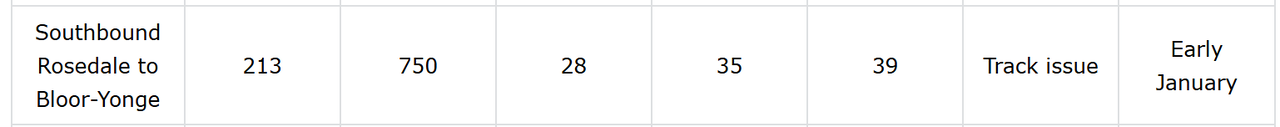

Sorry between Bloor and Davisville was better northbound only.

I was riding Line 1 SB yesterday (Dec 31) around 4:30 from Davisville to Bloor. The trains announced slower than normal travel to St Clair, and the outside bit south of Summerhill. I didn't think it was moving that slowly, though I wasn't particularly paying attention, and I was not in any sort of rush
The drop is only 4 km/hr. Barely perceptible.

Davisville was built on an old landfill. The ground is sinking there. To remedy it they need to dig down to the bedrock to stop the track from moving. It would require the line to be closed for an extended period of time.
What they should do extend the yard stub track by tearing down the bridge that it stops at. By putting that track Into service would allow bi directional travel while they fix one track at a time.
But south of the platform doesn't have a potential solution like that. Redoing all the ballast would provide some interim relief but I'm not sure if they could do it in a weekend closure.
As for Rosedale does anyone know what the issue is?

That's assuming that trains travel at that speed. I have noticed them going slower than that.
Seconded, it's all fine and dandy to read off the TTC website and claim "the slow zones are exactly X km/hr! You don't understand!"
In reality, as many subway riders will tell you, the subway is almost always slower. Not just slower than what the RSZ webpage would have you think, but much slower than the Google Maps / Service Summary advertised time as well. https://www.ttc.ca/riding-the-ttc/Updates/Reduced-Speed-Zones
I’m not an engineer but can you dig up one side to the bed rock without affecting the other tracks?
You wouldn't dig, but likely drive piles or install caissons. But I don't see you do that with a live track next to you, given some of the accidents that have happened in the past with drilling equipment falling.
I wonder if some kind of grout injection system might work - thinking outside of the box; but I haven't seen it in unconsolidated soils before - and I'm not that kind of engineer.
Yeah, none of that is going to happen so that section will always have slow orders no matter how many times they fix the track.
