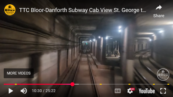

@smallspy I was looking at the video above and the way the tunnel is configured just west of Bay caught my attention.
That's unusually open and wide, particularly for an area without a cross over. Are you aware of any reason for that?
"Simplifying construction" is the answer.
That section of tunnel is two levels high - the stretch from St. George to Bay on the upper, and the stretch from Museum to Bay on the lower. Because of the use of an island platform at Bay there is a larger gap between the tracks, and so the whole area was excavated as a large cavern.
It's hard to see when looking forward, but you can note that the south wall is not aligned with the track the train is running on. That's because it's aligned with the track below.
The double-crossover cavern east of St. George is built in the same manner. There are walls at odd angles on both levels as they match up with the walls above or below.

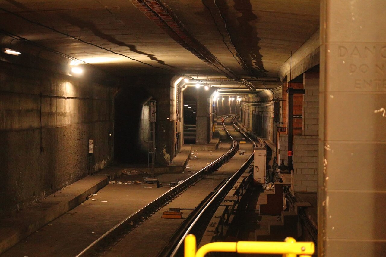

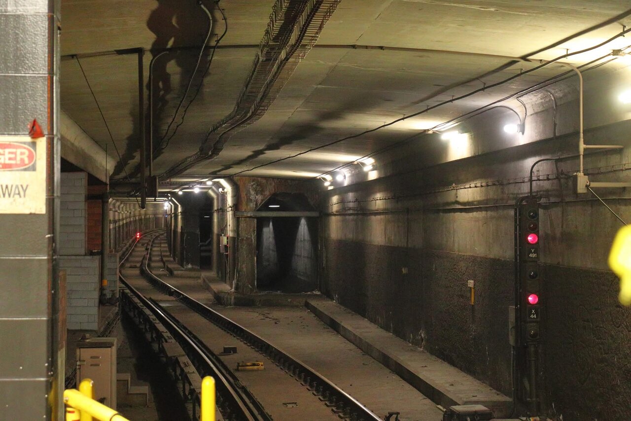

Some other views of the tunnel mess around Bay. The first two photos are from the lower level, the last from the upper.
