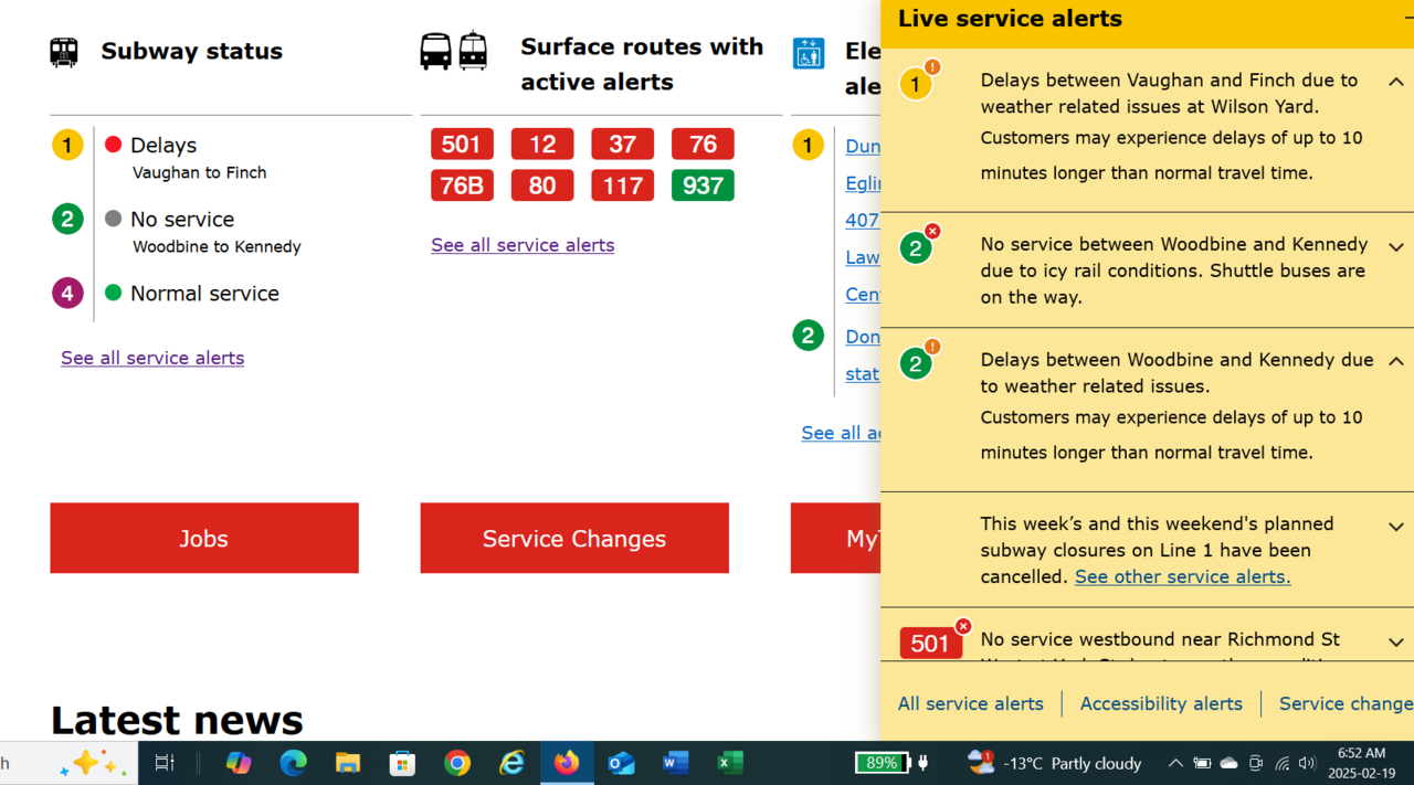

Go figure, the TTC still hasnt figured out to run trains properly during the winter months. No service from Woodbine to Kennedy so far this morning.
Side note, Line 1 has longer wait times still due to the Wilson Yard incident of a few days ago.
