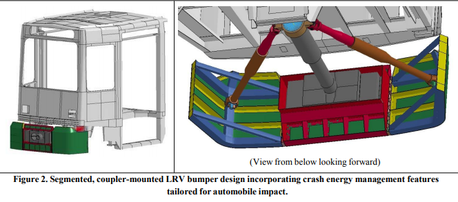

The resulting bumper from the FTA project showed marked improvements to automobile passenger safety for a variety of automobile types and collision scenarios analyzed. The results clearly show that careful selection of the front end bumper profile can significantly reduce the probability of injuries to automobile occupants. A profile that is low enough to engage the door frame structures of small and light vehicles, with an adequate vertical height to engage the same structures on taller SUVs, provided the best overall performance. Addition of a segmented corner bumper with energy absorbers further reduced the potential for injuries. Overall, the bumper design that encloses the LRV front end prevents struck vehicle override and occupant entrapment. It also helps to deflect pedestrian traffic without entrapment. [...]
Here's the study. I suggest reading it:
http://onlinepubs.trb.org/onlinepubs/IDEA/FinalReports/Transit/Transit77.pdf
Addendum: I'd also suggest considering this, complete with a video for those who have trouble reading:

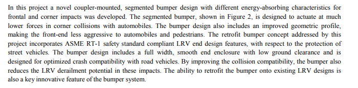

Collison Safety Improvements for Light Rail Vehicles ... - ROSA P
It's 60 pages. It might entail having to read and understand. Full report downloadable for free at this link.
The following abstract is for the ASME site paywall for the same report:
abstract
The majority of fatalities that occur from light rail vehicle (LRV) operations are occupants of automobiles that are struck by the LRVs. Recent developments of crashworthiness standards for LRVs by the American Society of Mechanical Engineers (ASME) Rail Transit Vehicle Standards Committee included consideration of a wide variety of crash scenarios including collisions between LRVs and street running automobiles. The requirements included in the standard are primarily to create an enclosed front end geometry where the struck vehicle will not be entrapped or overridden. A smooth enclosed front end profile is a primary requirement for improving the compatibility of LRVs colliding with automobiles. More recently, a study has been initiated by the Federal Transit Administration (FTA) to develop LRV front end features that further improve the crash compatibility with automobiles. The approach depends on results from computer simulation modeling of vehicle collisions across a wide variety of LRV bumper designs, some with and some without energy absorbers. Results of the study and the design of the energy absorbing bumper system are presented.
https://proceedings.asmedigitalcollection.asme.org/proceeding.aspx?articleid=1648458
