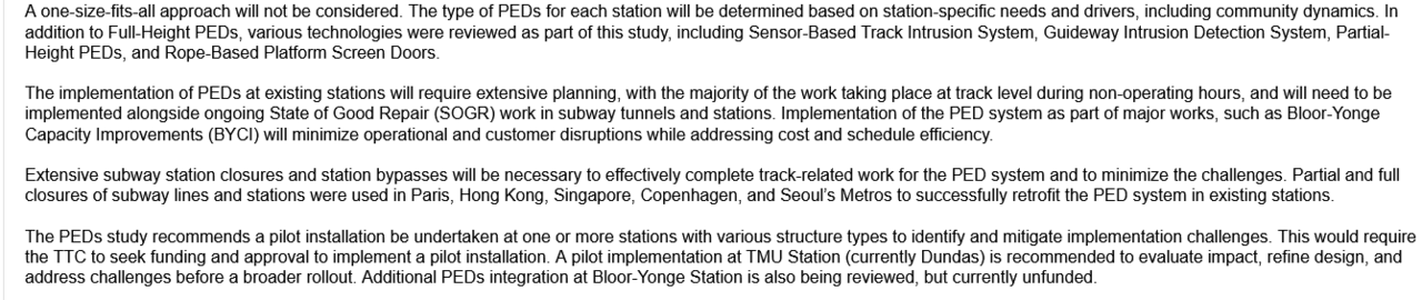

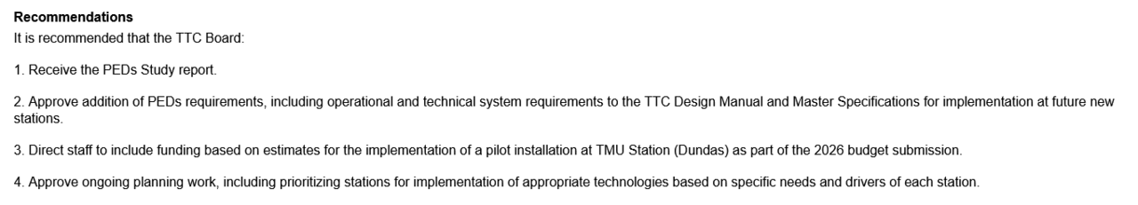

A Report to next week's TTC meeting updates the Commission on the Business Case and Feasibility studies for Platform Edge Doors.
Spoiler.....we're going forward.

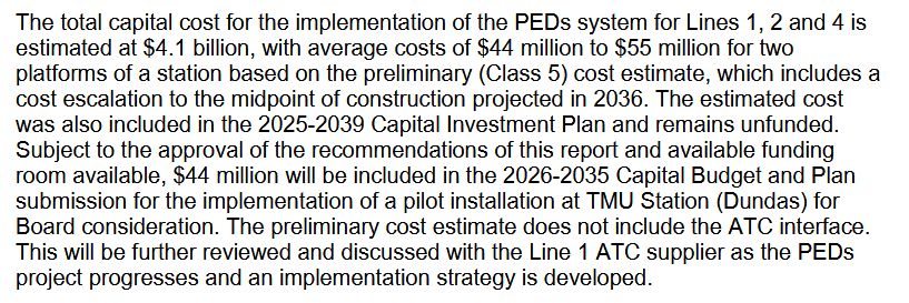

You'll see below a reference to Bloor-Yonge being unfunded.....I've explained my read on that....... but of note, if this is adopted, B-Y will not be the first station, they will pilot this at Dundas/TMU
Next bit....I'm going to say right now, even understanding the escalator they are using..........I find the estimates unacceptably high.

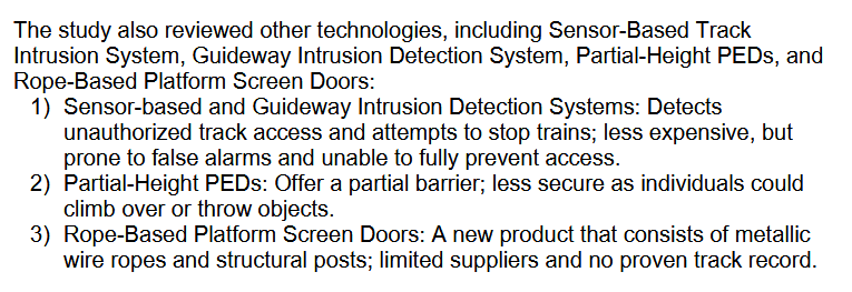

Clearly whoever wrote this "study" has never set foot outside of Canada. Theyve been using rope based doors in Asia especially in korea for years and represent a solid alternative that is the best value.
How can they say theres "no proven track record".
They just skipped right to the most expensive option. Ill bet this will die off a slow agonising death just like GO RER.

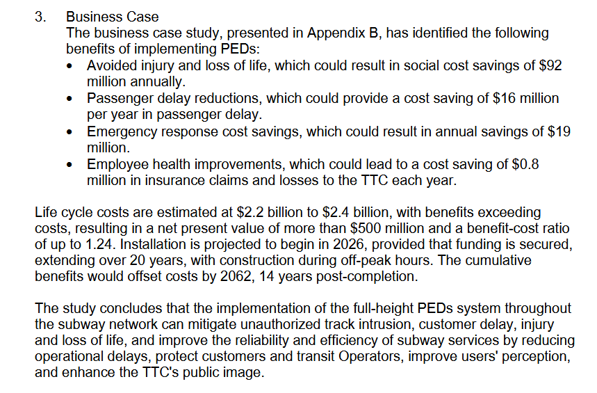

also 20 YEARS?!! most of us on this board will be old or dead by then.... too expensive for too long of a construction period.

I read the report and they did not say there was no track record. They said there were limited deployments (accurate).
They are deployed lightly in Asia outside of Korea and even in Korea they are not the preference. They are quite possibly the least expensive, whether they are actually the best value is highly debatable - they are less functional, don't align with the doors, and create different hazards.

I disagree. PEDs aren't a "cadillac" solution, they're the standard for a reason. On a system with Toronto's ridership, the way we mitigate costs is by prioritizing stations of high use where incidents are most likely to occur, not by putting together a half-assed solution that will end up being cursed out and torn up a few decades down the line. We don't need this equipment "last decade", certainly not as badly as we need to resolve slow orders or add a second platform at Bloor-Yonge.

I'm not sure they are that common, if the Korean Wikipedia is to be believed the example in the report is the only installation of these type of doors remaining in Korea, all others have been converted to full height doors. There are probably a few in Japan, but the only one I know of in Tokyo is at the JR station at Narita Airport where both limited express trains and regular commuter trains with different door spacings have to share the same platform.
If you read the report the TTC clearly already has it's preferred vendors too (and a strong preference for vendors that are already established in North America), and don't want a system that's an orphan and where every component has to be shipped from Asia.
