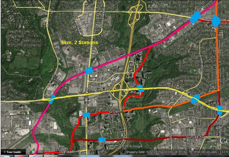

Second Segment: (South-East) North York
Targets: 1) ECLRT Interchange. 2) Other Stops
This is about 6 km, with several possible routes, with about 2 stations.
With ECLRT not being grade-separated, it makes it difficult to find a strong preference on where to cross Eglinton. Vic Park makes some sense as the busiest location, but it means another crossing of the hydro corridor. Near Leslie, alongside the CPR is easiest bus misses serving Flemindon. At Wynford, through the Don Valley is another option.
Depending on exact routing of DRL, could have an interchange at Don Mills/CPR, or at Science Centre, or leave the interchange for the Thorncliffe area.

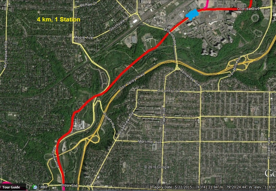

Third Segment: Thorncliffe and Don Valley
Targets: 1) Thorncliffe
This is about 4 km, with only 1 station.
The only stop here is at East York Centre Mall. Depending on DRL alignment, an interchange could be made with the DRL could be made, although near Science Centre is another possibility. The other goal here is to find a route that is fast, inexpensive, and disturbed the fewest number of NIMBY's.
I like the CPR alignment through Leslie the best. It is perfectly placed for massive redevelopment of the whole Don Mills north of Eglinton (Celestica grounds and surrounding area) site. If Toronto is truly going to have explosive population growth by 2040, this is an area where I think we must convert a lot of brownfield sites and employment lands into denser residential lands. The station location is also neatly in between Lawrence and Eglinton on Don Mills, so interchange with the Relief Line is warranted too.
I wouldn't worry about serving Flemingdon Park with this line. The Relief Line would take care of that no problem.
As for alignment south of Thorncliffe Park, depending on the type of vehicle intended for this line, I would simply have it take the DRL tunnel and branch it off to Union after crossing the Don River.
Using the Vancouver model, this transit line would be fully grade-separated, and elevated for its entire length. Some very short at-grade segments may be possible within the Don Valley, but not enough to achieve any real cost savings. I tried to stay away from residential areas when in low density area. When in residential areas, a stop within 1 kilometer is required - a benefit to put up with having an elevated line. Pick coridors that have not previously been expecting underground subway, so it will be viewed as improved transit from what was previously offered. I would assume the capacity target would be about 30k ppdph, which would require about 100m long trains (and stations) and 100 second frequency.
