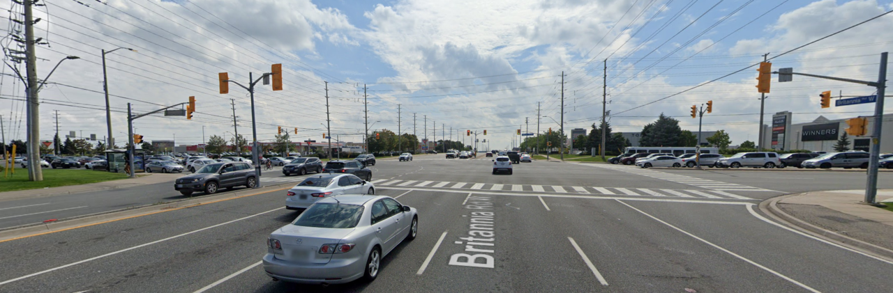

I can see the merit of two way streets if volumes and speeds are low enough for one lane in each direction. We're talking 6 lane arterials in the suburbs, which fan out to 9-10 lanes at intersections. We're stuck with a wide concession spacing of arterials which means funneling a fair amount of traffic on each of them, rather than distributing more widely over more, narrower streets. This is a way of taming these massive beasts so that they are able to flow cars as effectively as today while being less horrible (and far less dangerous) for vulnerable road users.
The bus shelter next to the McDonalds on the SE corner was a victim of a car collision a few year back. These intersections are absolutely insane from a safety standpoint and they don't even perform that well for cars.

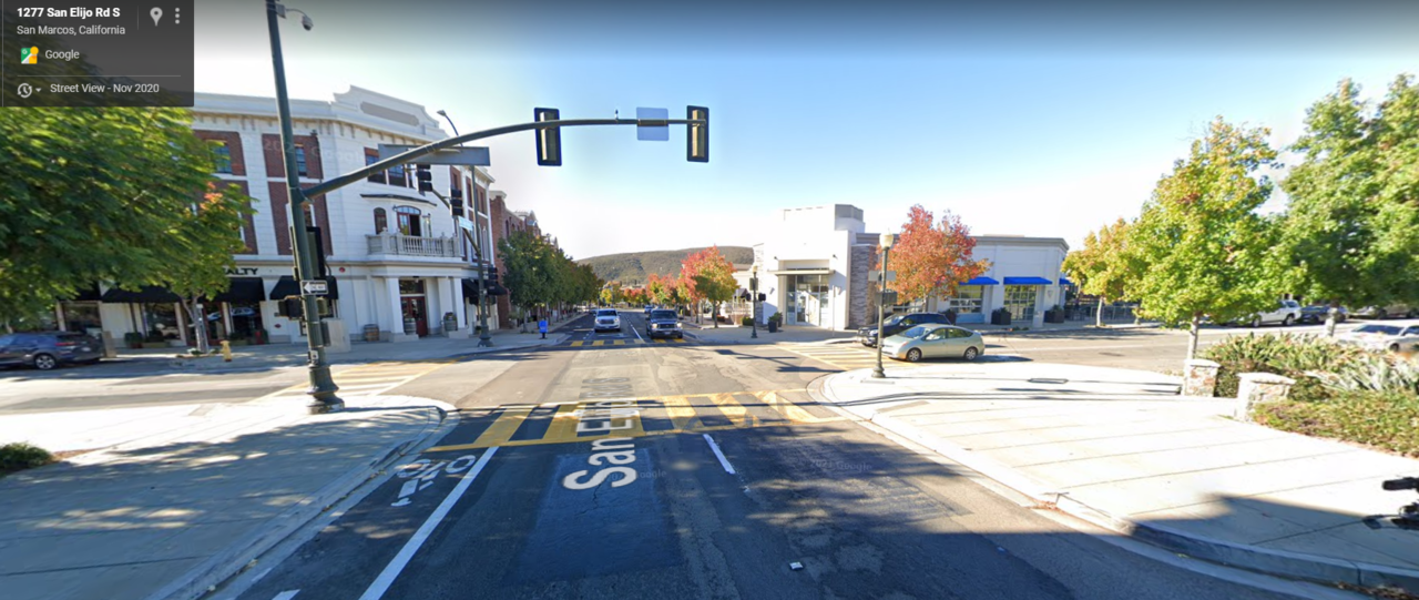

I guess we're comparing crossing this:
