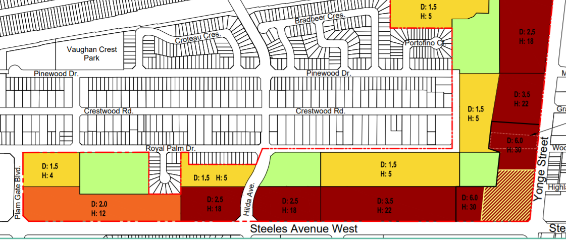

Not sure if this is related. But here is a massive proposal for Yonge And Steeles. Could be a result of the Subway being extended.
It calls for the Centerpoint Mall to be replaced with 18 Towers.

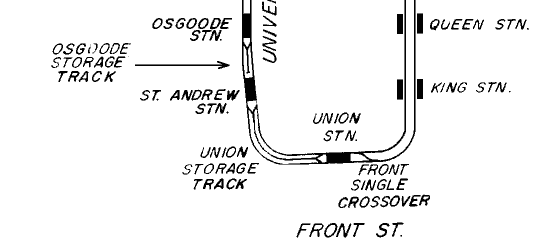

Union Station?
From link.
The Yonge leg would use the north side of Union Station. The University leg would use the south side of Union Station. The Union Storage tracks in the middle between Union and St. Andrew would become a northbound track for the University leg.
The north side tracks between Union and St. Andrew Stations would become storage tracks.
In 1963; the scissor crossovers at the east end of Union was replaced by a single crossover. Whether or not they return the scissor crossovers return depend if they need it for maintenance purposes during off hours or not. See link.
To be practical, the wall between the north platform and south tracks would have be taken down. Union Station would become "Spanish Solution" platform. The University trains would open doors on both sides. With platform screen doors, of course.

Union Station?
View attachment 373534From link.
Are there any long term disadvantages to using the storage tracks as the primary tracks? Will the switches/crossovers need replace/maintenance more often?
And look at all that lovely yellowbelt just across the street that can never be touched!
Union Station?
From link.
Except, as I posted in the Centerpoint thread, there is a new Secondary Plan that will make some decent chunks of that yellowbelt, on the Toronto side, extremely touchable, within matter of months.
And of course, the Secondary Plan for the Vaughan side was passed back in 2010 (But still at the OMB!). So between the two, there isn't really much yellowbelt to seen in this area.
