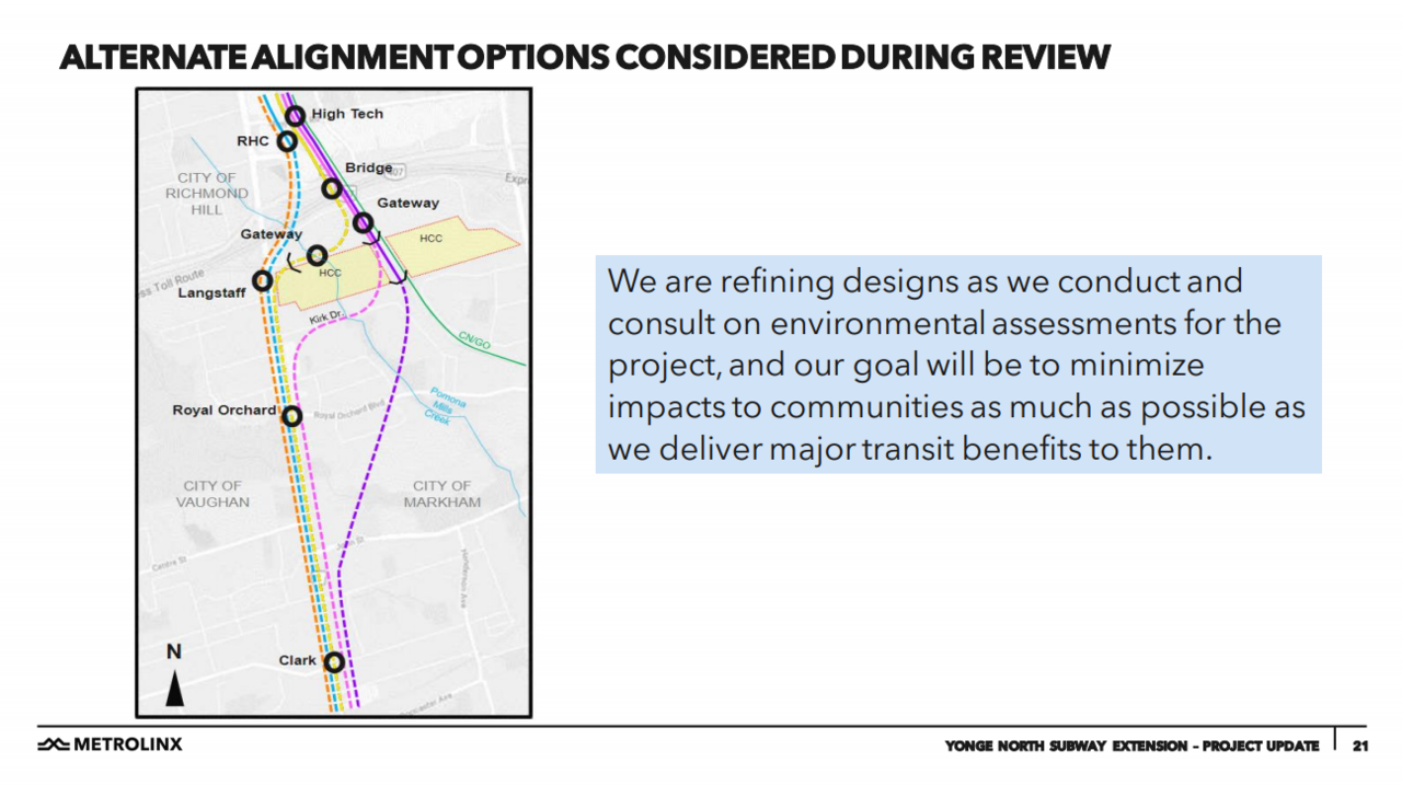

For the people on here like Syn who are complaining that the Richmond Hill line is underground for too long, well here's a brand new alignment just for you that runs away from Yonge Street - serving absolutely nobody at all and heads straight for the rail line, while also only spending only an extra 200m aboveground. What an amazing investment and alignment, wow. (/s)
On a more serious note, this map suggests the creation of a Gateway Station south of Bridge which... please no. Its kind of difficult to justify having both Bridge and High Tech so close together, having a gateway station even closer to bridge south of that seems even more extraneous, although again would probably be cheap since its already above ground.

So that image you included just shows the options they considered but not the final alignment they are going with, right?
I read that map as saying there's High Tech and then they were deciding between "Gateway" and "Bridge." There's no discussion of Gateway at all in the Initial Business Case, that I recall. I think you have to look at is as, the goal was to bring the line up to Royal Orchard and then get over to the GO corridor as easily as possible, and then figure out where stations go. So, for people who think High Tech and Bridge are too close, clearly they looked at doing something south of the highways but it looks to me like, proximity aside, Bridge makes far more sense for transit connectivity.

That is correct. Specifically its new alignments that Metrolinx is studying based off public feedback.
