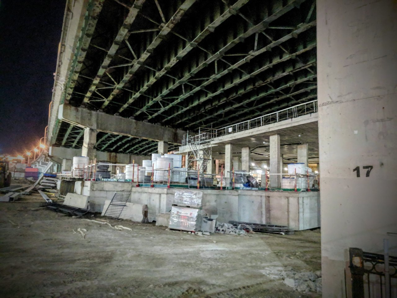

I went by the construction site tonight and was surprised by something. Apologies if this has been addressed before, but how did the city approve the creep of the condo podium under the Gardiner? I mean they just put up the podium almost up to the Gardiner support structure all the way underneath it. Is the Gardiner never going to be repaired/replaced/demolished? Is it made of everlasting materials that never need maintenance? How is this building not in the way of all of that in the future?
The city doesn't actually own that land - they presumably just have easements across it for the Gardiner. You may remember that previously the old warehouse building went under the Gardiner with the support columns running right through the building.. It'll be maintained the same way this stretch always has. There are access and buffering easements to ensure maintenance can occur.
Yes - there's a "buffer" area around each column all the way down to the foundation
Maybe this type of thing will eventually cause it to be torn down as the complexity/cost of maintaining will be so high it's not worth keeping.
