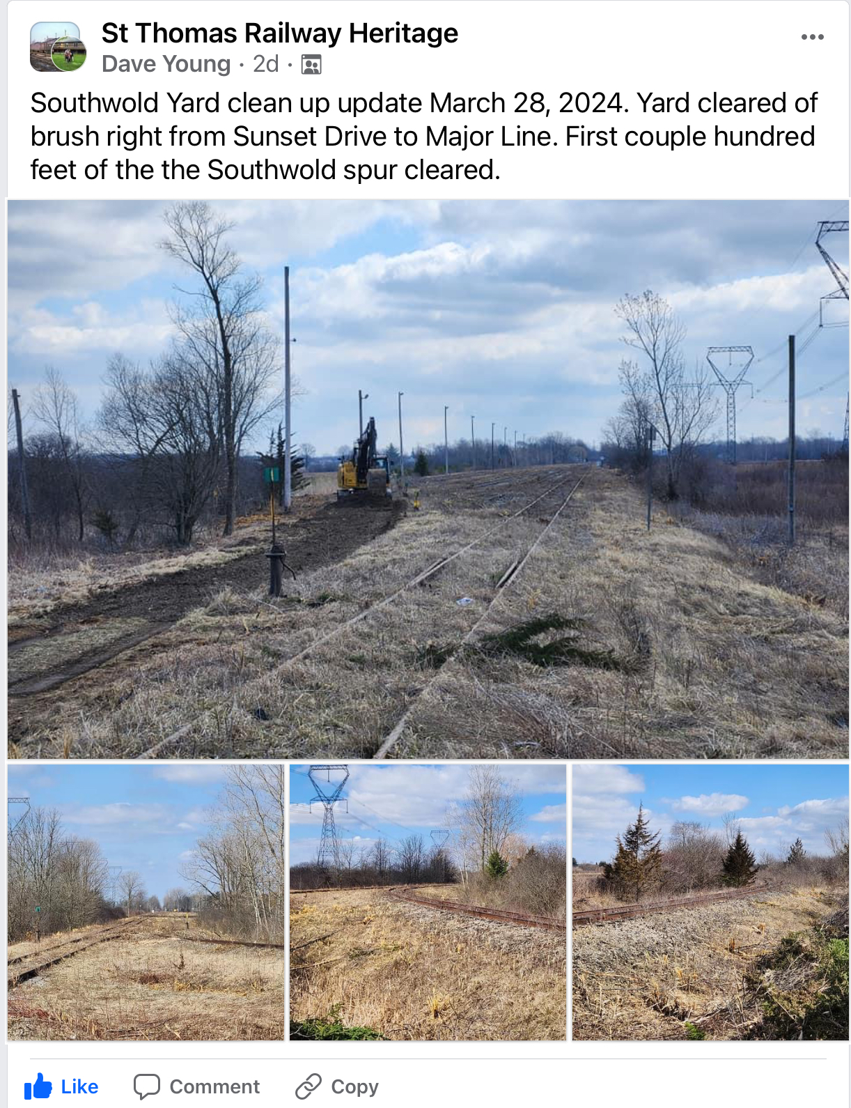

Found this on Facebook. CN is cleaning up its old Paynes Sub in St. Thomas. It was completely overgrown and impassable in recent years. It connects to the opposite side of St. Thomas from the VW plant, but has an old yard on it. CN might be planning to use it to store or marshal cars for the plant.

I don't have any official or even back door information, but some informed people I talk to have been musing about CN's industrial development around St Thomas for quite a while now. While it may have appeared that CN had decided to pull out of St Thomas altogether, they have held onto odd bits of track - and even paid to keep up some of it - in ways which made people wonder if there is more to the strategy... the loss of the Ford plant was a blow, but St Thomas may be a sleeper lication that was seen as having industrial development potential all along.
CN has certainly laid out a line in the sand with its spur to the VW plant and one does hear that CN and the city have been in discussion about various other things around town.
The interesting angle to me is the whole business of interswitching. It seems unlikely that VW would site its plant in a location where they are limited to being served by only CN, and certainly there is another route into town that would allow another railway to also serve the plant....just as auto plants in Woodstock/Ingersoll and Oshawa have dual railway service. People who wonder why CN and CP don't cooperate more.on other things might watch this one as it may be a situation where their most competitive instincts come to the fore.
The other comment I have heard is about the grades required if spurs were built to connect the plant from various directions. I haven't looked at any data on this, but it would be interesting to know how steep the line will be, if at all.

I know some of the old track/yard near downtown St. Thomas was sold off for development. Not sure about the rest, you would likely know better than I.
