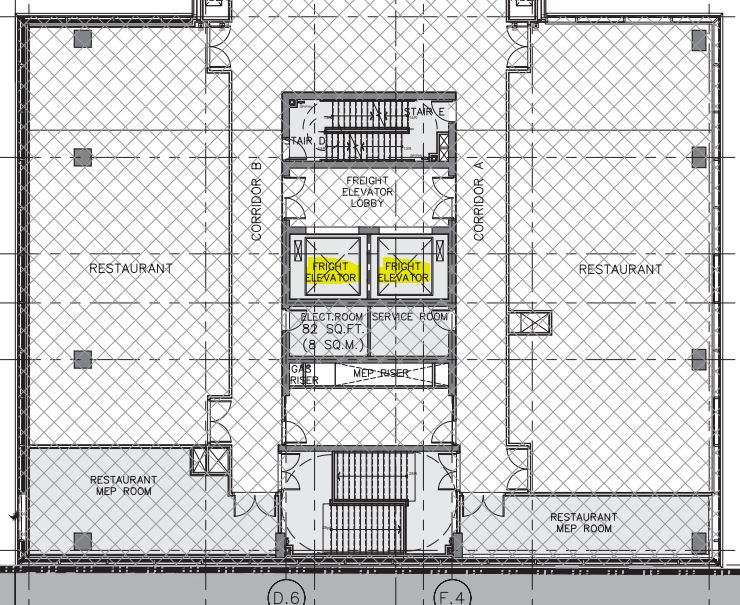

...but if my memory also serves me correct, I believe that may also be using main elevator core for their hoist elevators, normally reserved for outside of the building being constructed. Which may also be a consideration in all of this.
It probably is also due to safety that they are not placing steel above this level due to the reach of their lifts, (that could be completely wrong but I know I wouldn't want to work on an elevated platform at that height with good gusts of wind like we had yesterday).
As for the material hoist, if the plan hasn't changed, it is on the outside of the tower and on the back side of the podium, skipping across the podium roof. Installing elevators takes months - it wouldn't be a great idea to top out and wait on an installed elevator on either west elevator bank or podium freight elevator without a hoist running as the the project climbs. As for when the project is climbing, there are definitely some cool plans that were discussed about how to move workers faster up and down the building - just have to wait and see what they chose to do
