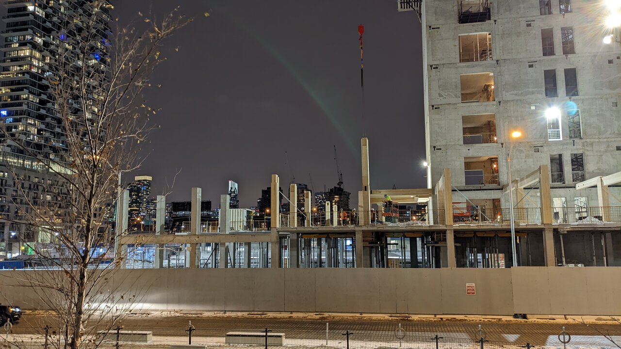

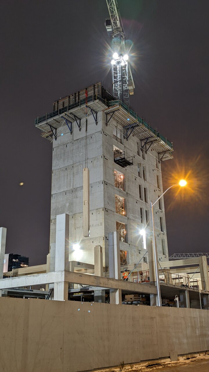

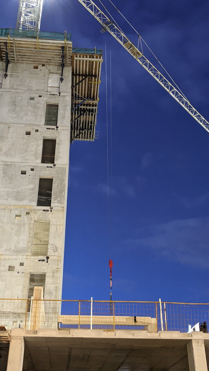

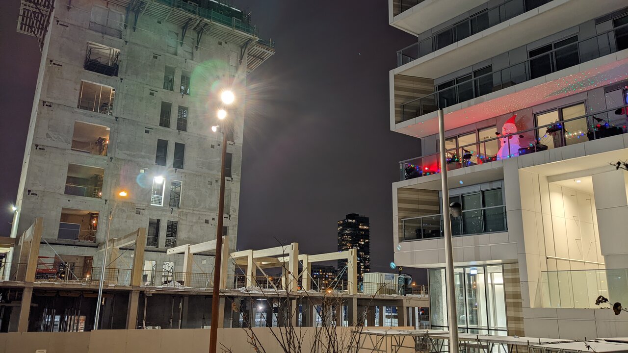

Is there always this much concrete in a timber building? I get the elevator shaft but I thought that it would be limited to thatAt work after dark with some double height posts.

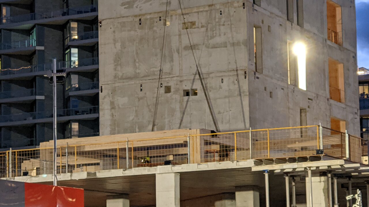

Some of the multi ply floor (slab?} from a couple days ago.
For my understanding, timber tends to be a better medium for vibration transfer than concrete which is oft not desirable. So I suspect the concrete may help attempt to dampen/tone that down a bit.Is there always this much concrete in a timber building? I get the elevator shaft but I thought that it would be limited to that

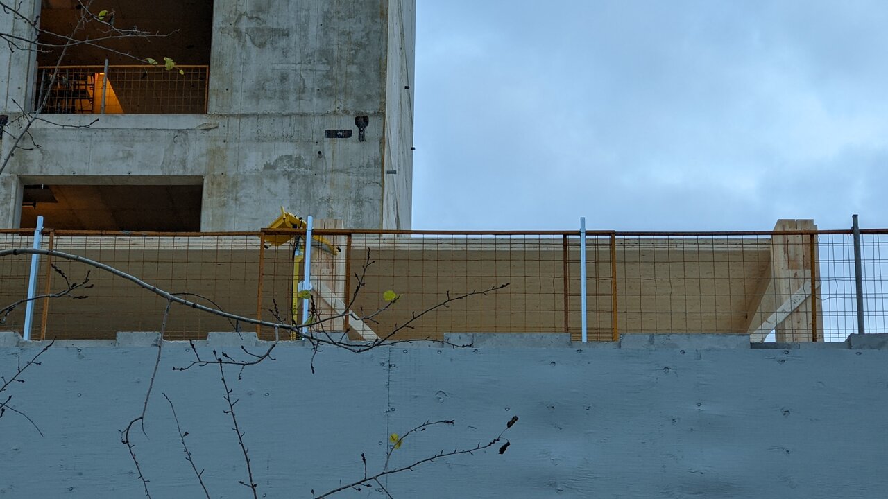

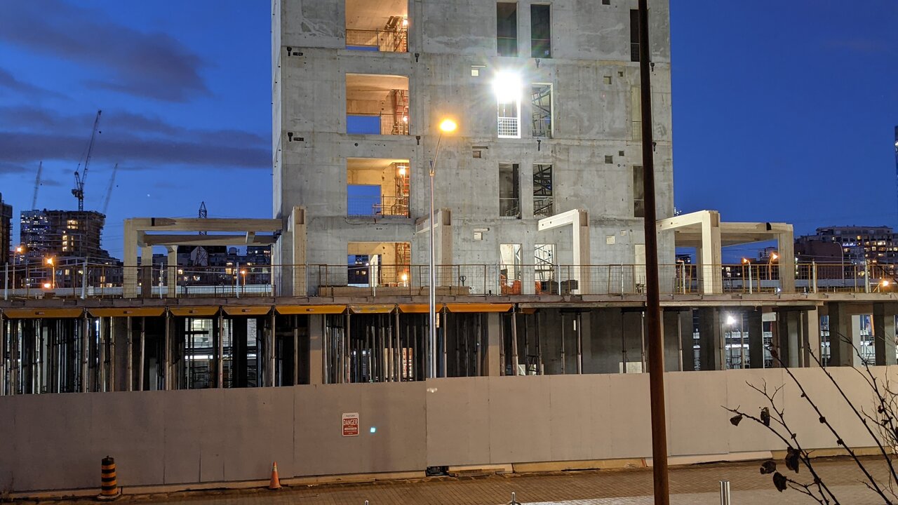

I'm a little surprised that the glulam isn't sheathed in something? When the AGO went up every single piece of material had a plastic sheath on it to protect the glulam from the elements. Has the technology just changed in the last decade to make the material more weather resistant?
And how are they protecting it during construction? Those columns look like they'd be ruined the first time someone tries leaning material against them. How's the floor going to stand up to scissor lifts and spider cranes driving across them? Or is this wood the structural wood, and finished millwork is to follow?
The only other significant glulam installation I can think of in Toronto is the AGO, so I'm curious how it all works!

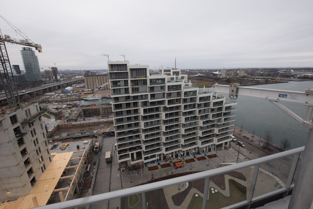

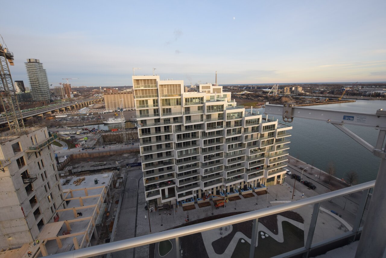

I may be incorrect here, but what is that below grade excavation between T3 and Aqualuna? Is that not the affordable housing block? Have not seen much about it so I would be suprised if construction for it has already begun?
