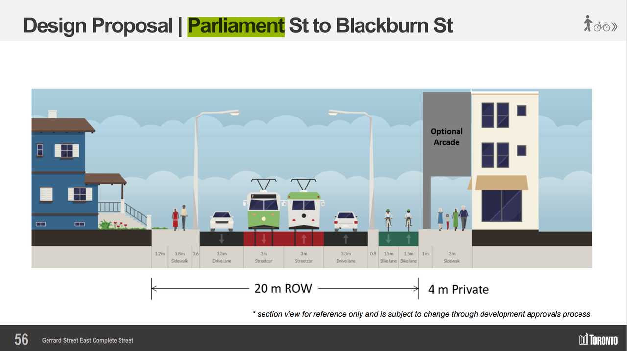

But all documents I am aware of indicate that the former option (reconfiguration of ROW via expansion on southside) was/is being pursed. Please take a look at transportation services Gerrard Street East | Complete Street Connection. The document's introduction reads:
Further, slide 56 includes a street-mix representation of the ROW, which indicates four mixed-traffic lanes and bidirectional cycling facilities on the south side:
But having walked/biked by over the past weeks, it appears there is not enough room to accommodate a proper sidewalk and 3m of cycling facilities. I wonder what has changed. Are they planning on ripping the road up, narrowing the existing lanes, and reconfiguring the road once this is all done ?

There is approximately 7.7M from the curb to the face of the building.
The curb lane of Gerrard here is ~3.5M wide (which provides at least 0.2M of additional space.
I believe there is sufficient room here to incorporate a bi-directional bike path of 3M, and I assume the design has been laid out this way pending road reconstruction and further developments along Gerrard.

2029? That's brutal, though glad the slide @Undulated shared shows it could be possible to install the bi-directional cycle track without removing traffic lanes. Not sure how this could work crossing the DVP with the current bridge setup.
I am disappointed that some of the recent developments couldn't incorporate the cycle track at the same time to save on unnecessary duplication of work, though it goes to show the need to improve co-ordination with these developments and other capital works projects.
