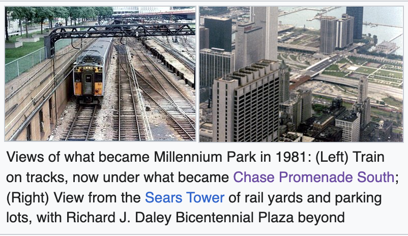

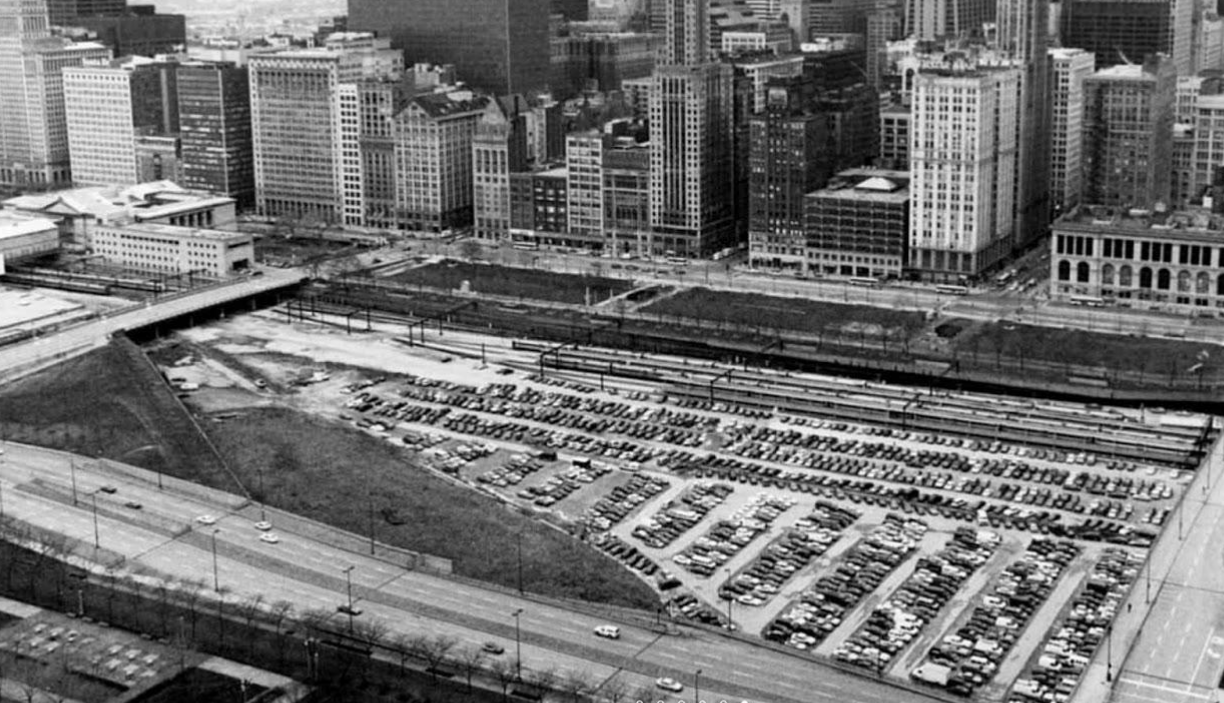

Just so we're clear, Millennium Park, 20 years ago, cost 475M USD to deliver. Over 200M of that from private donors.
Adjust that for inflation, and the exchange rate and we get:
1.8 Billion CAD, conservatively.
A price of at least 83M per acre
Now, why do I say conservatively? Because the rail yard that was built over in Chicago was far less challenging than Toronto's.
Most of the Chicago site was former rail yard, and actually being used for surface parking. The park actually sits on the parking garage roof.
See site below:
Image Source: https://blogger.googleusercontent.c...ea3a8o3P/s1600/July+20%2C+2018+Blog+Photo.jpg
Given that difference conditions, I would factor in a difference in price of at least 100%
That would put the budget at over 166M per acre.
Simply put, we can do far better putting those kind of resources to work elsewhere.
