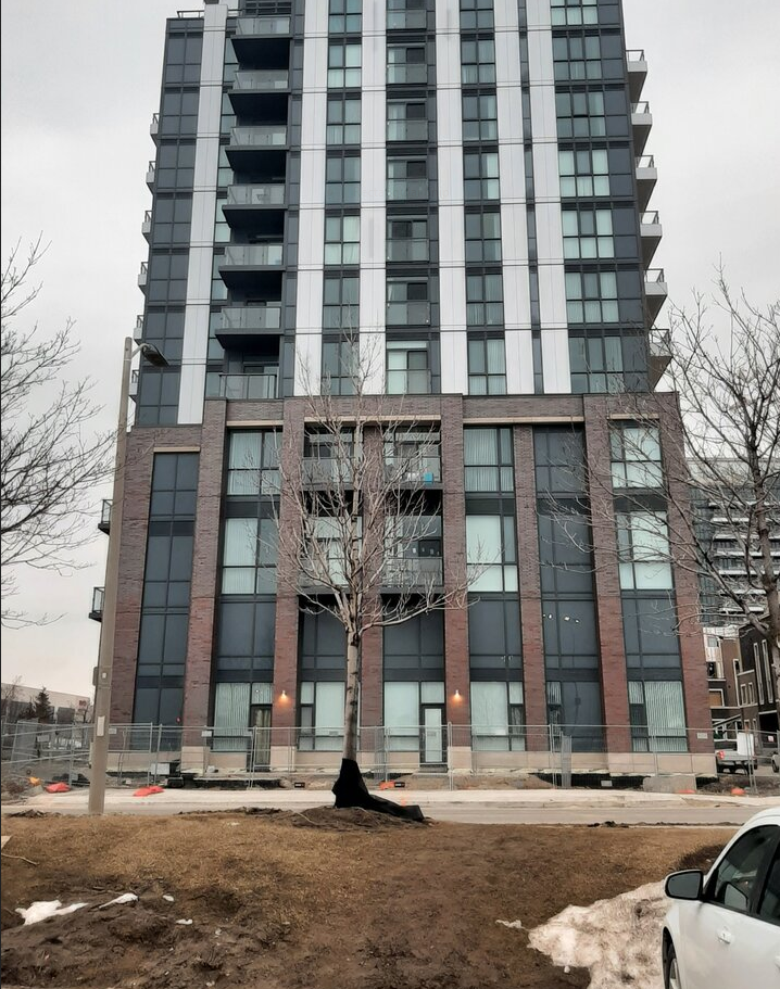

On a related note...........what the @#$# is this?
Let me get this straight, you've got the rootball of the tree sticking out, uncovered, above the ground, on an embankment that has all water draining away from it, and looks compacted as all get out.......and you expect the trees to live?
Good for you! Glad I'm not warrantying them.

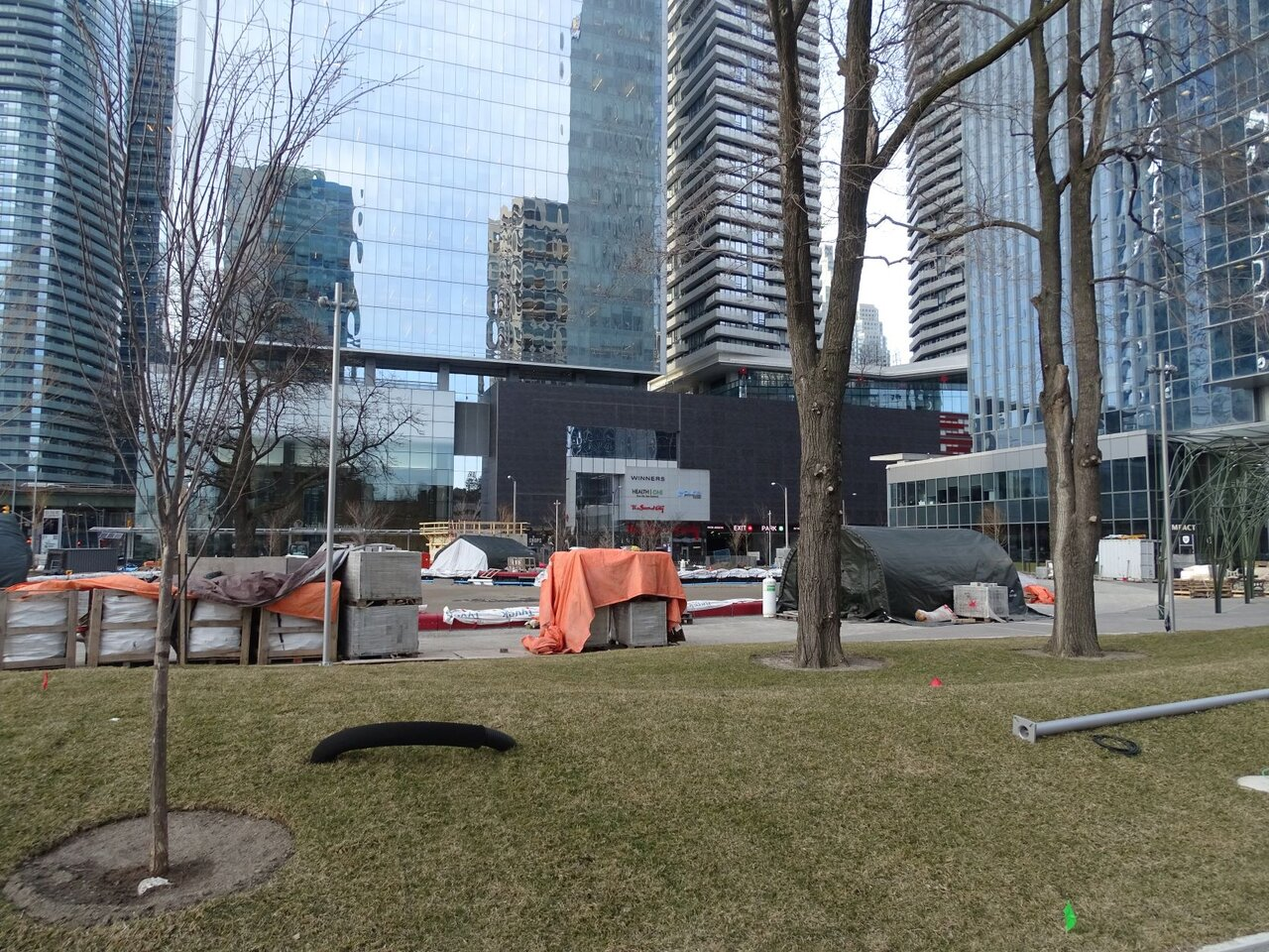

Edit to Add: How its done properly:
The above is from my photos of Love Park; by Cormier.
Notice how the tree roots are not visible and the tree is planted level w/the surrounding soil.
Also note that the tree is not at the highest point of the landform, so water can run down to the tree, but not pool around it. (which would be bad)
You can't visually assess the compaction in this photo, but I can tell you the soil was groomed into place, not steamrolled.

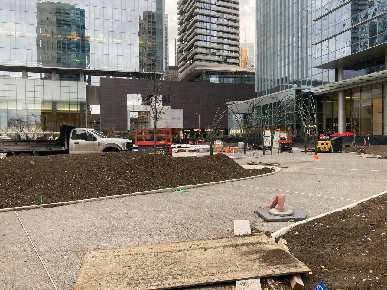

You see this in @Rascacielo 's pic of the site from last fall:
Correct!
